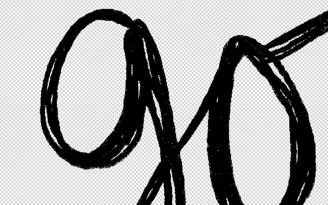

I need to make some simple ink drawings usable for putting on tee-shirts. As in, they need to be solid black (with the color being able to be easily swapped) and with crisp/clear edges that don't have any blur. Basically I'm looking to make a raster image work a little like a vector image (crisp edges and easy to swap the colors). The raster images I'm using are scanned in at a high resolution (600dpi).
I'm used to making tee shirt designs using Illustrator, but as of right now I only have access to Photoshop.
All of my designs are simple one-color designs, and are meant to be white against a black background. I would also like the option to make them black against a white background, which is why I would like to make the drawings easily color-swappable. Once again, I'm used to doing all of this in vector, so the switch to Photoshop has been kind of an adjustment for me 😅
Here is an example of one of the scanned drawings that I am trying to do this with:
Other than using Contrast/Levels to make the drawing as black as I can and knocking out the white background using Select Color Range, what else can I do? I've tried Bitmapping the drawing at a 50% threshhold but that just gives it slightly jagged edges. And tracing vector paths over this with the Pen tool would take FOREVER, lol. Is there another process that I am overlooking?

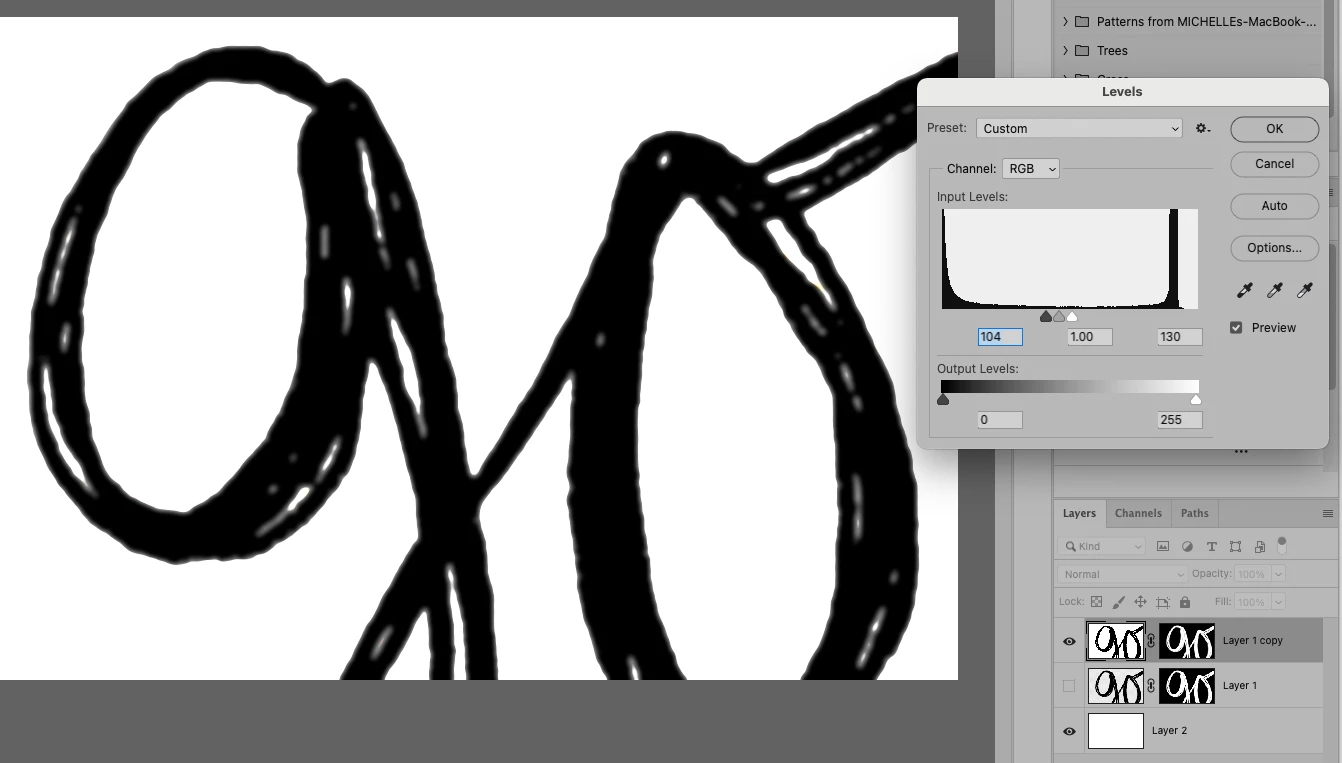

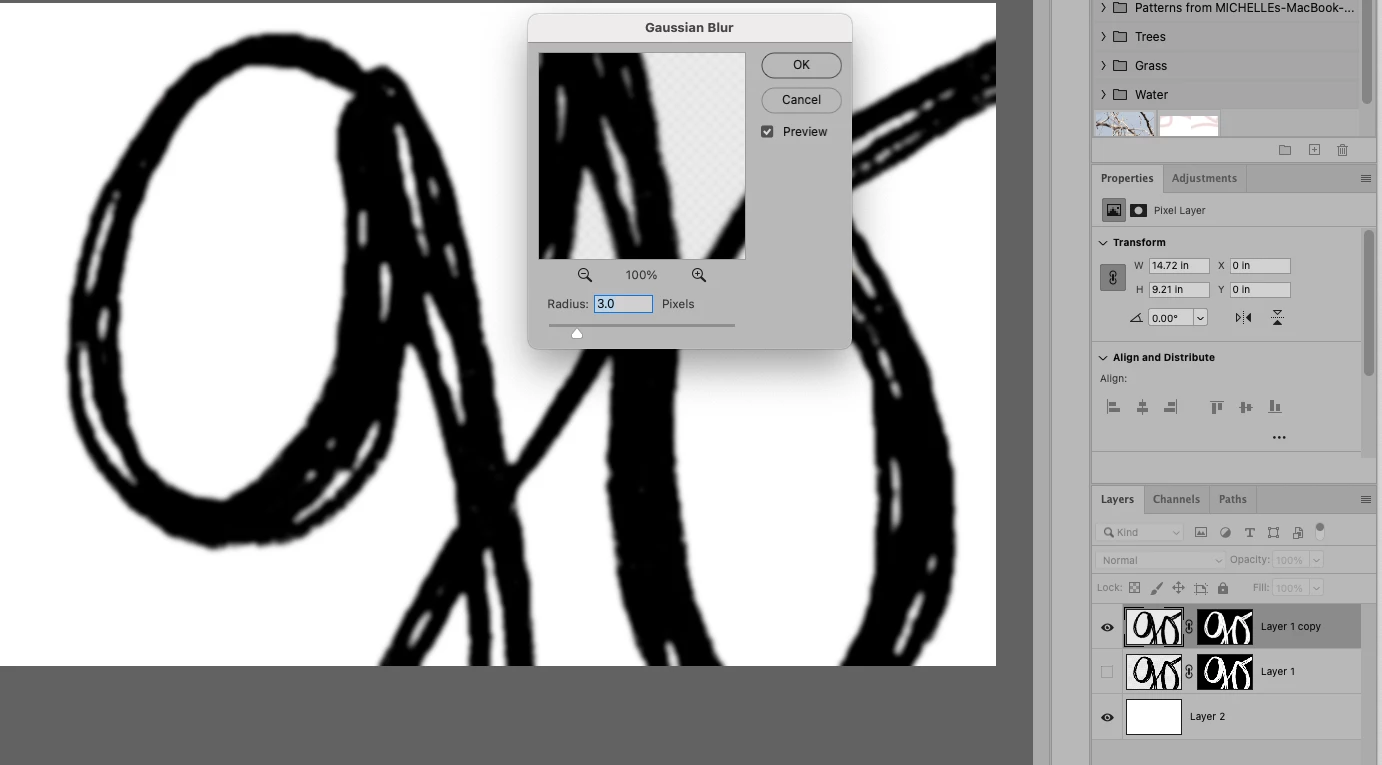

Hi Kitsume,
I thought you might like to see the steps that bojan was talking about. I took a screen shot of your image and deleted the gray and white checker board to show you these steps. The numbers might be different if you have a higher resolution.
1. Isolate your artwork by using a layer mask.
2. Apply a Gaussian Blur, see the dialog box for amount.
3. Use levels and bring in the  black and white sliders to the middle (see image). You can move the sliders to the right or left to either make it darker or open up the whites a little more.
Michelle
Thank you. This is exactly what I did to get the image to look the way I wanted to 😊
