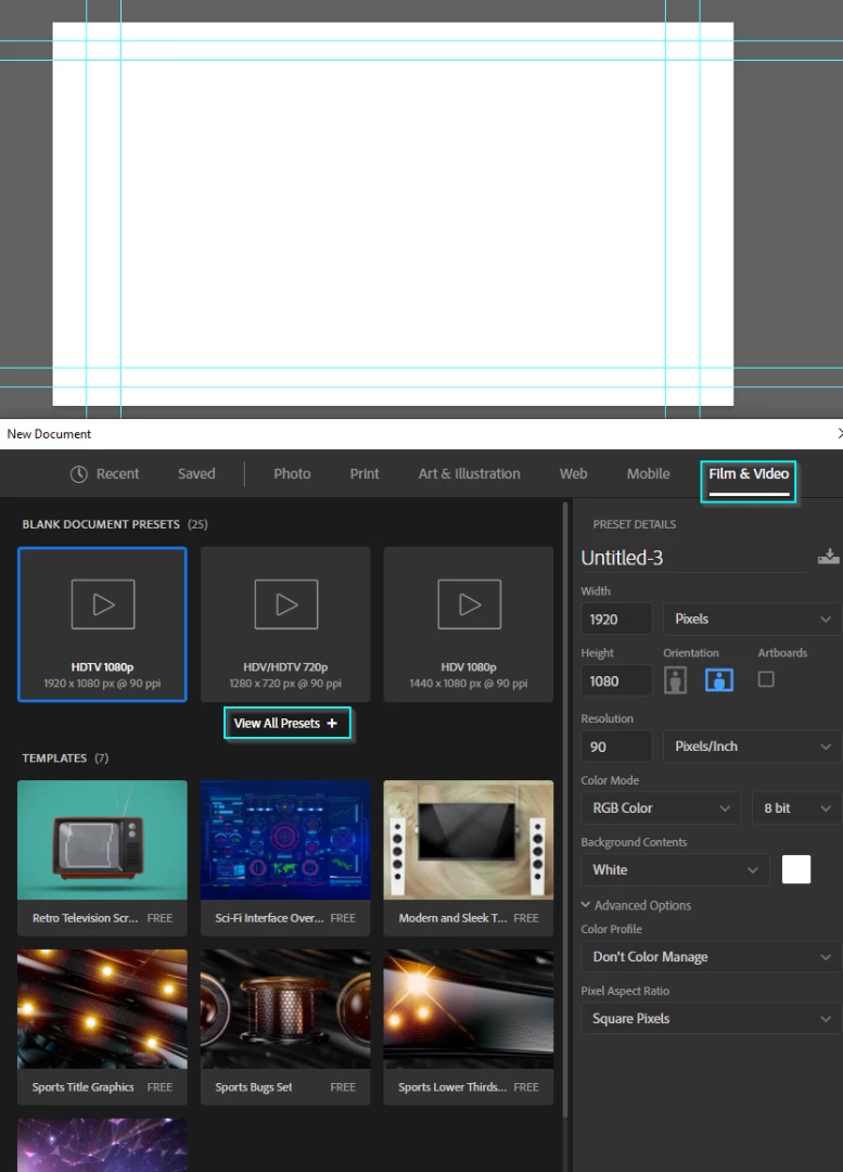

Julia, a wee addendum, Photoshop has useful range of presets for video formats complete with Guides for safe area and title safe area.
If you scroll down there are a range of presets with things like lower thirds, but these have to be downloaded.  They are free though.
Premiere pro has similar functionality.  The lads in the Premiere Pro forum would know how this stuff works, even if you are not using Prem Pro.

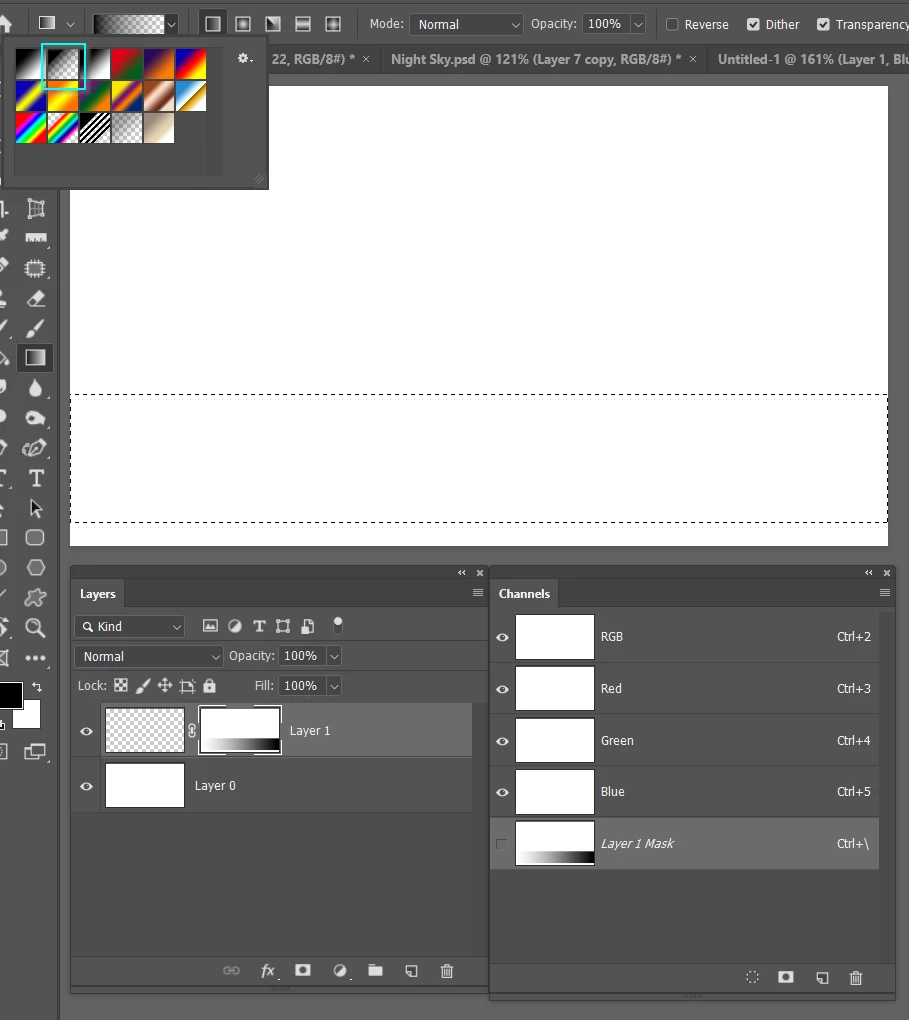

What app are you using the lower third in?  Premiere Pro or Photoshop maybe?  Prem Pro works really well with PSD files.
Anyway, create a document the same size as the video frame
Create a new layer and add a layer mask
Select the lower third  and the gradient tool with Foreground to transparent
With black as the foreground colour and the layer mask selected, run your gradient from right to left

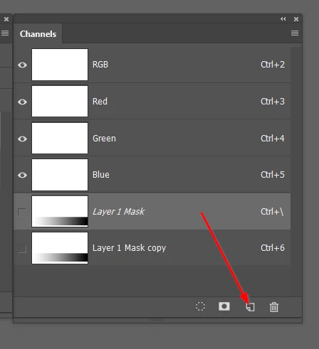

The alpha channel will only show in the channels panel while the layer is selected, but you could drag it to the new channel icon to make it permanent.

Design the bar. Use a layer mask of white (show) to black (hide) to fade out the layer. Select the mask and save the selection as a channel to create the alpha channel.
You'll have to save to a format that supports alpha channels. PSD and TIFF are good choices. Don't use JPEG.
