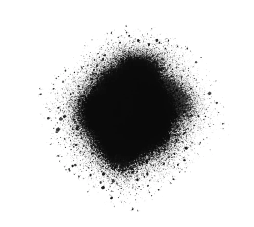

Here is a brush I made
You can define that as a brush, then put some size and rotation jitter and paint your borders
