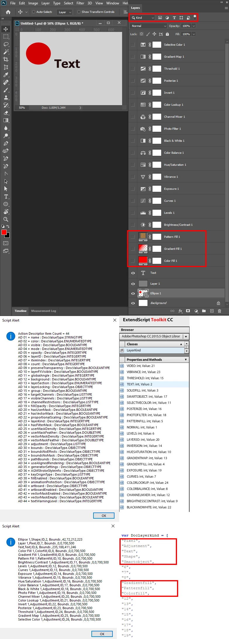

how to make alert for circle shape
  • January 2, 2020
  • 645 views
 i know how to get  kind of solid layer
if(_layers[i].kind == LayerKind.SOLIDFILL){
  alert("rectangle");
but what`s the kind of ellipse (circle shape) i need to make it in alert and thanks for you

JJMack
January 2, 2020
Also  if the layer bounds does not have a 1:1 Aspect ratio the layers is not a square or a circle.
I also do not know if all solid fill layers are Shape Layers or that all Shape layers are solid fill layers for shapes can have no fill, a gradient fill and a pattern fill as well.
I also do not know Action manager code and when you get layer descriptions using Action manager code the code seems to have a different  layerKind  list than DOM LayerKind.  Its list seem to be like the Layers Palette Kind Filter (Pixel, Adjustment, Text, Shape and Smart Object)  + three fill type (Colorfill, Patternfill and Gradientfill) I had map Action Manager layerKind integers different the DOM LayerKind integers.
JJMack
Stephen Marsh
January 2, 2020
Unless I am missing something, whether you are adding a solid fill layer or a shape via one of the shape tools, the layer kind is still a LayerKind.SOLIDFILL layer kind.
Perhaps there is a way to get live shape properties or to do complicated math based on vector path co-ordinates...
