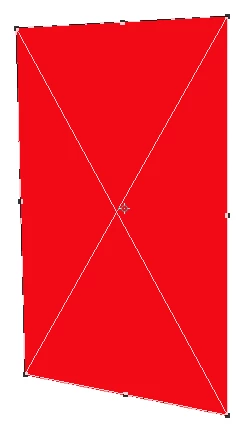

A wee tip when aligning rectangles to 3D faces like a parallelogram with perspective.  It always pays to make the layer you are Free Transforming a Smart Object.  The reason is that if you need to fine tune the alignment, the next time you start the Free Transform process, the box and handles will form a new rectangle perpendicular to the document boundaries.
With a Smart Object, no matter how many times you repeat the Free Transform, the handles will always remain on the original corners. This makes it a lot easier to align the corners and sides to any perspective aids you might have used.

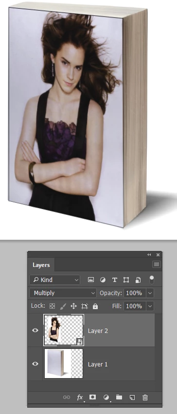

Depending on the colour and tonal value of the cover, you might be able to simply use a blend mode.  I have added a small stroke so you can see the outline of the picture, which has a white background.
If I align the image and set its blend mode to Multiply, the white becomes transparent
