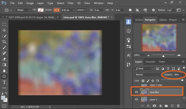

With any filter, you can adjust the value to suit.  Also the opacity of that layer can be reduced.

October 21, 2017
Open an image of almost anything.  It can be a still life, a city or seascape.   It doesn't matter what it is as long as you like the colors.  Copy the layer with Ctrl+J.
With Layer 2 selected, go to Filter > Blur > Lens Blur and give it a high radius.
Adjust Layer opacity as desired.
Before Lens Blur
After Lens Blur
