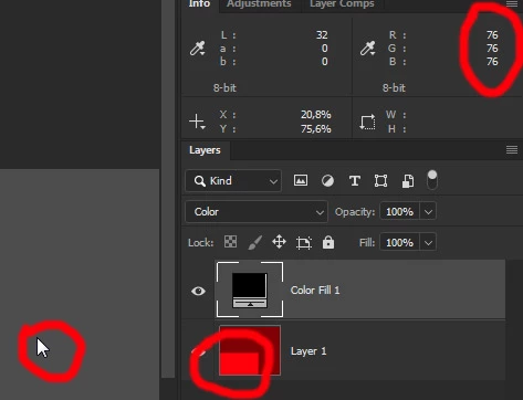

Explain with an example with a picture, with screenshots, how you got 76 from RGB (255,0,0).
Zesty_wanderlust15A7
June 6, 2021
Cursor is over the Red 255 area.
It's ok to be one number off (rounding?), but I wanna be very close to that. 

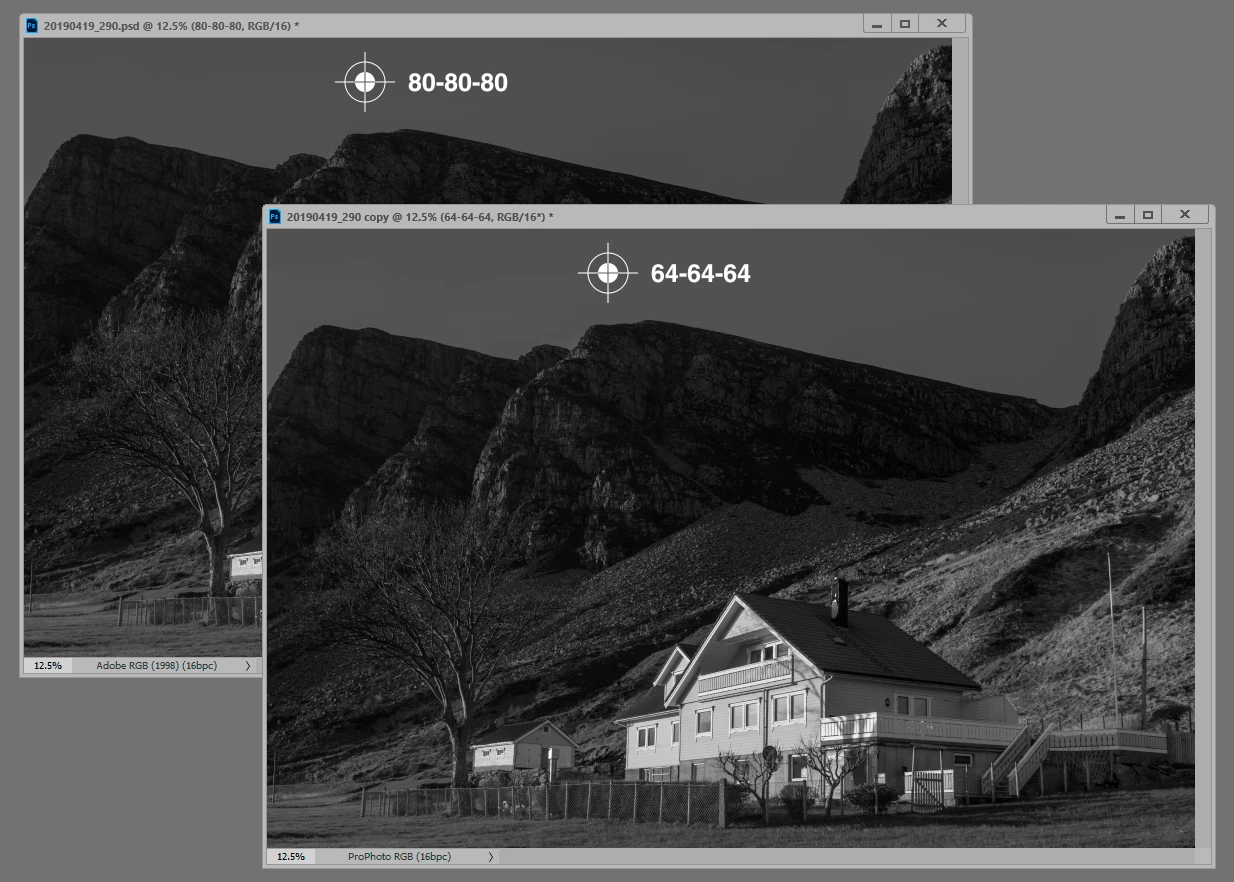

There is no such thing as "true luminosity". It depends on the color space used, because they have different tone response curves.
Here's the same image in Adobe RGB (gamma 2.2) and ProPhoto (gamma 1.8). This is by your method, a solid color gray layer on top:
In true grayscale, it will depend on your working gray, or assigned grayscale profile.
If you want a "standard" value, the closest thing is the Lab L number.
