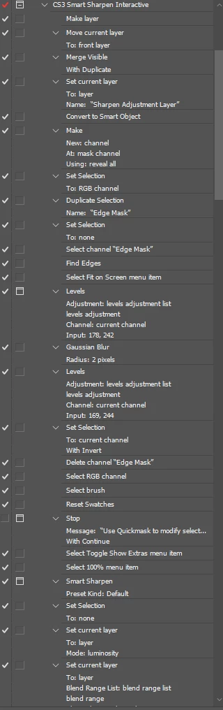

Save a file like Jpg.  Your  opened document  in Photoshop will still be layered.  The Jpg file will contained  flatten image.  In Photoshop you cans also add a additional layer and stamp the composite of all visible layers into it.  That layer will by like a flattened image.  I create these all the time as work layers for things like sharpening and adding image effects by blending in the work layer I modify like sharpen into the document. In an action I record Shift+CTRL+Alt+N followed by Shift+CTRL+Alt+E and the move layer to front Top of stack.
