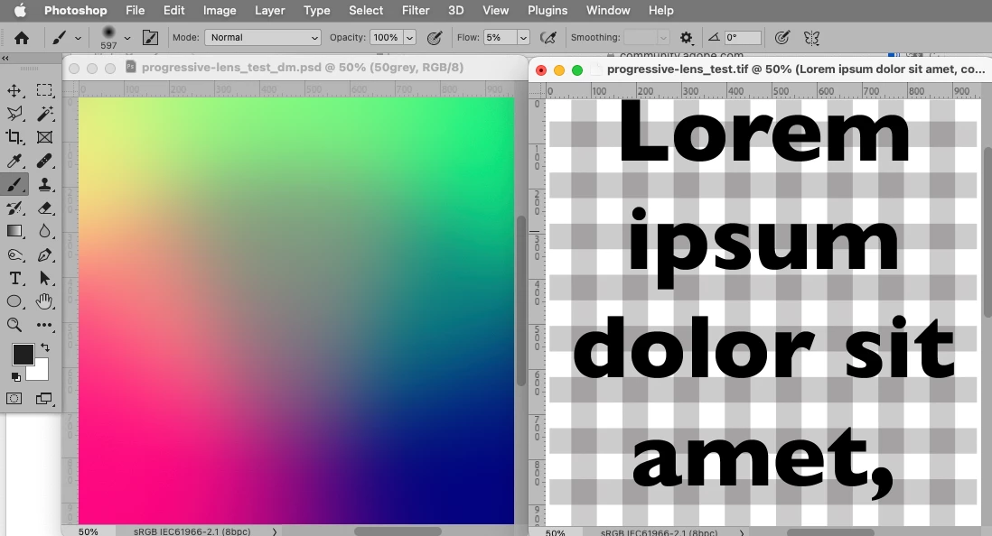

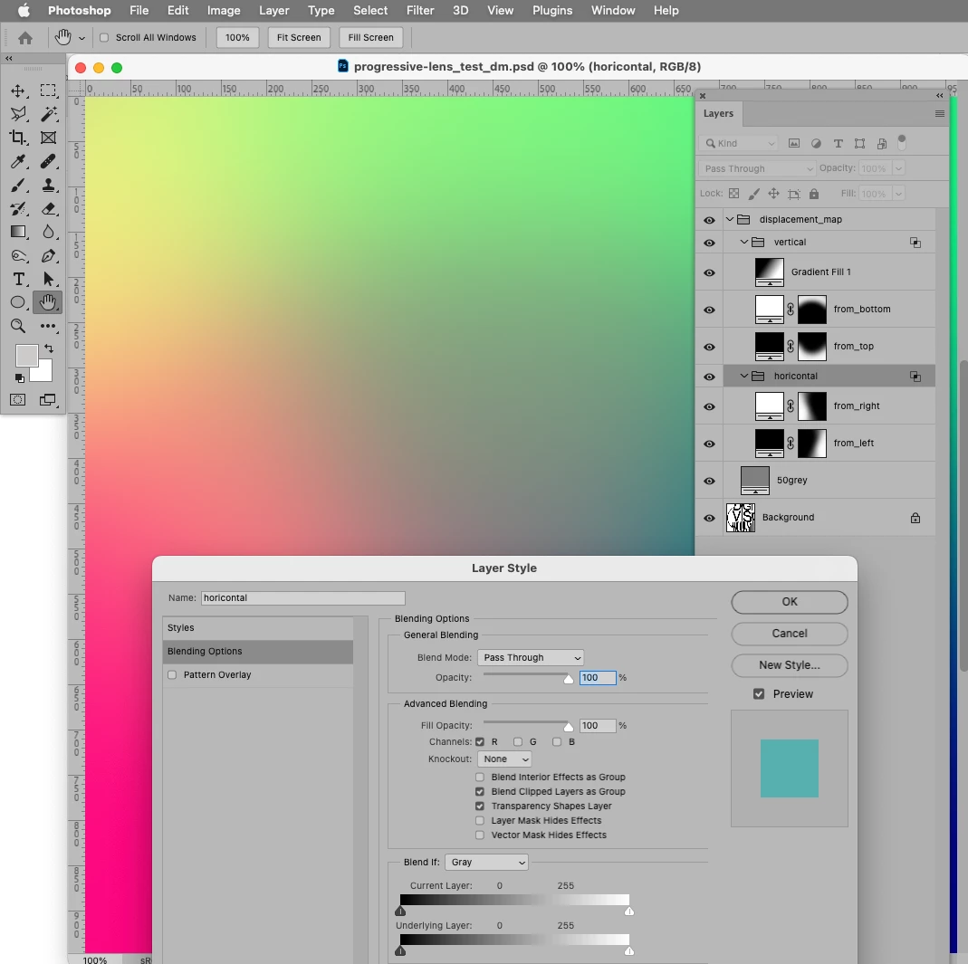

This looks to be the right solution – but what did you actually use as the displacement map?
c.pfaffenbichler
May 13, 2023
I painted it.
The Red Channel for horizontal, the Green Channel for vertical.
But Warp may produce better results (especially for large images).
For a couple of versions Warp has allowed adding additional grid-lines manually; unfortunately the feature has not been implemented in a truly sensible fashion in my opinion.
