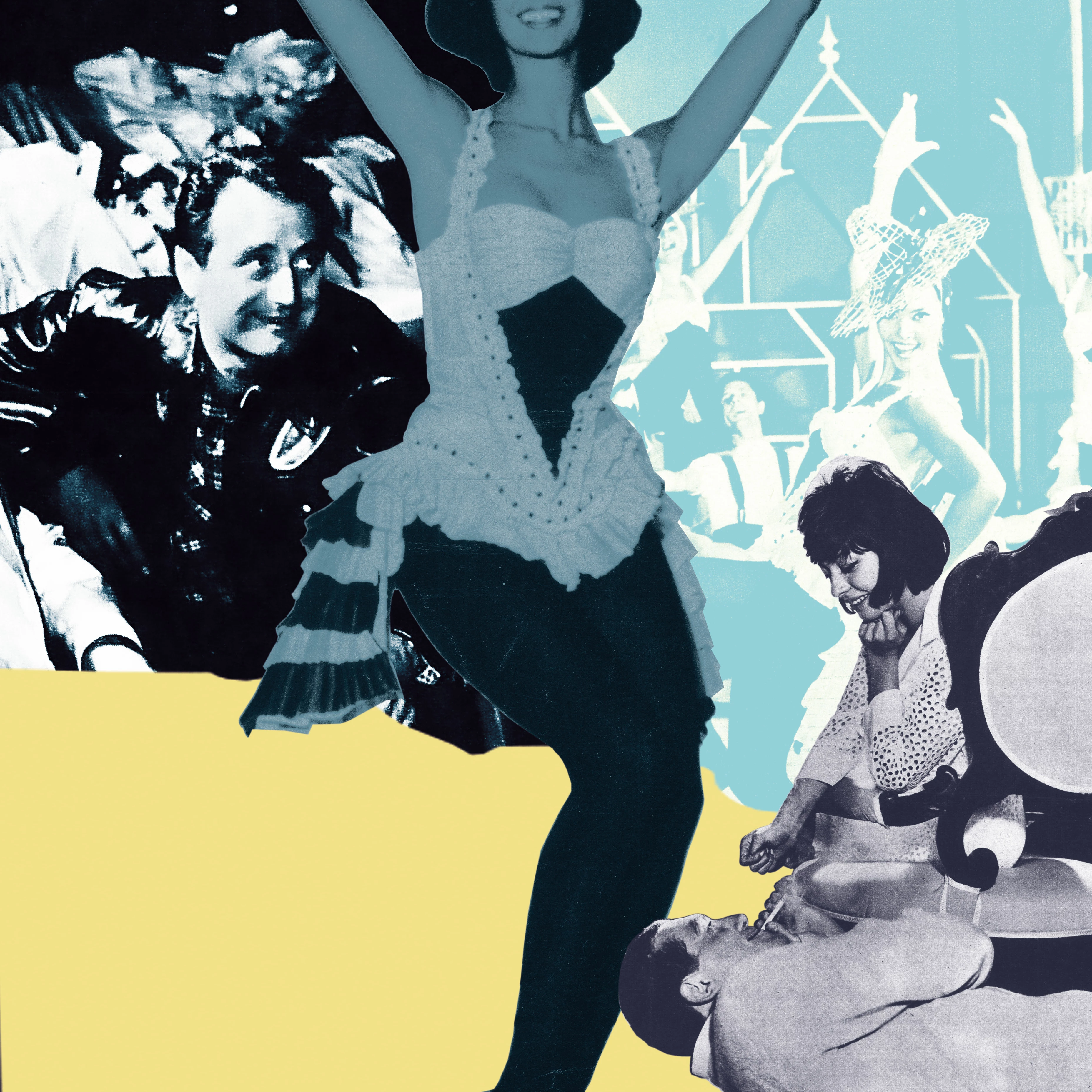

Thanks everyone for responding!
Although the final piece really depends on what images one is sourcing, I believe @didiermazier latest post is really getting close to the original example, especially in achieving the central character hue.
I've found the use of gradient helpful as well.
Here is my final result

Good Venture
April 4, 2020
Thanks everyone for the help!! Very much appreciated so far. I didn't think about using the gradient adjustment layers at the beginning.
Here is the work in process:
I'm not yet satisfied with blacks, but maybe could they be corrected as the last step?

I see some Smart Objects but several plain pixel Layers without Layer Masks and with the effects applied destructively apparently.
And as far as I am concerned that’s not good.
As for the »blacks« you can use Curves Layers for example to esit each Layers’ contrast.
