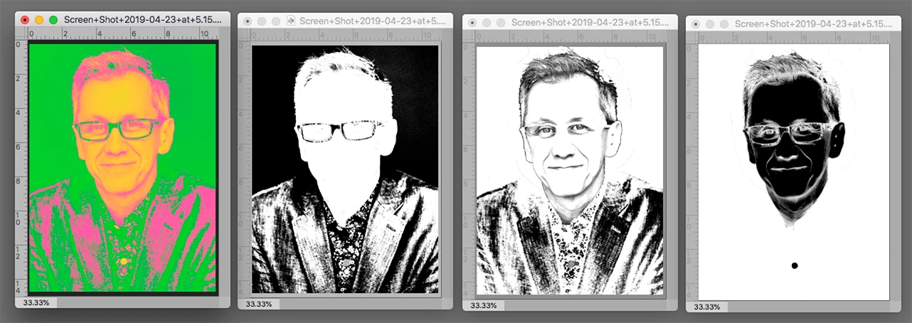

Hello I'm working on some colourful portrait images that are printing bright CMYK and one spot (PMS 804 - orange). They are rather psychedelic in tone. How do I properly change them from RGB to CMYK + 1 spot and retain the vibrancy and layering effect. I know how to create a spot channel for the PMS 804 but I'm having issues retaining the images overall look. Please see image attached.

This image requires 3 plates: Green (1) , Magenta (2), and Orange (3). The face modeling and hair color looks different from the magenta shirt color because it is a magenta and orange overprint. (Unless specified, printing ink is transparent.)
Since you supplied a composite image I used Lab Color' a  channel to create the Magenta and the Green image and the  b  channel to create the Orange image.  Since this will be printed in flat color rather than values of. process colors you can expect a more robust, dramatic result. This is a thee-color printing job. I suggest you specify the colors by their PMS numbers.
(I didn't realize you had this art preseparated already when I read your initial inquiry. Certainly use your own layers.)

Right now the image is divided in layers, purple, green, orange (spot) and yellow above it. The layers blend to produce the image. We are going to use the orange as the spot channel but I’m not sure how to have it blend with the others to produce this outcome. I was just going to convert to CMYK as I normally do through the mode option.
