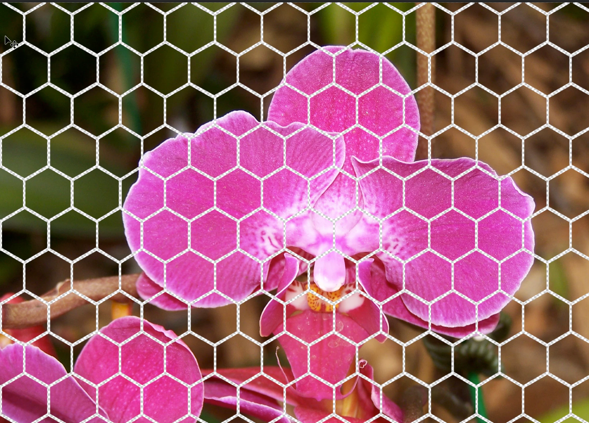

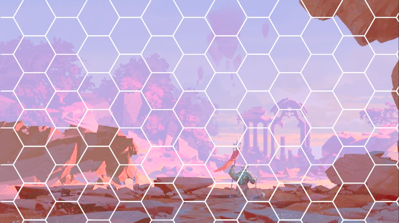

I simply googled "photoshop hexagon shape download" and came across one at freepik.com.
I added it as a layer mask.
I made the lines thicker so the shapes would be more prominent in the image below.

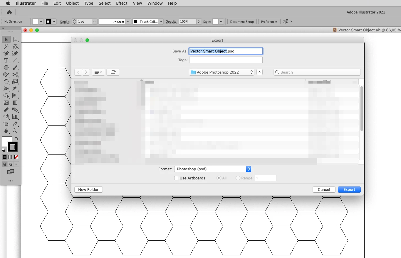

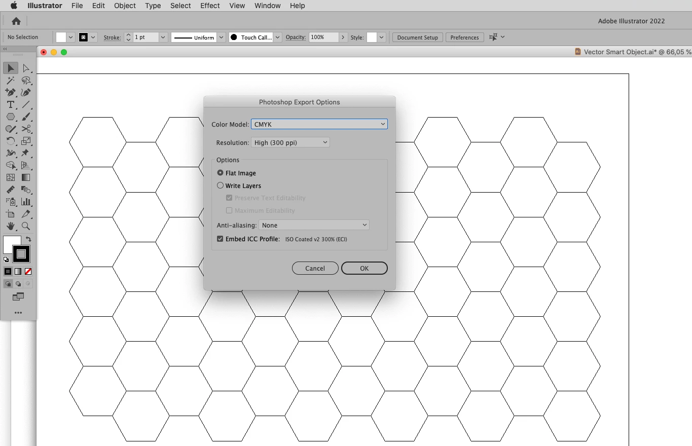

Another option would be creating the hexagonal pattern in Illustrator and exporting them as psd without Anti-aliasing.
Then Clipping Masking Smart Object instances to the resulting Layers in Photoshop.
That way one can easily switch in different images in the Smart Object and then, if necessary, merge the instances to the hexagonal Layers with an Action.

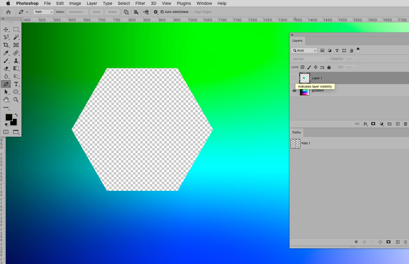

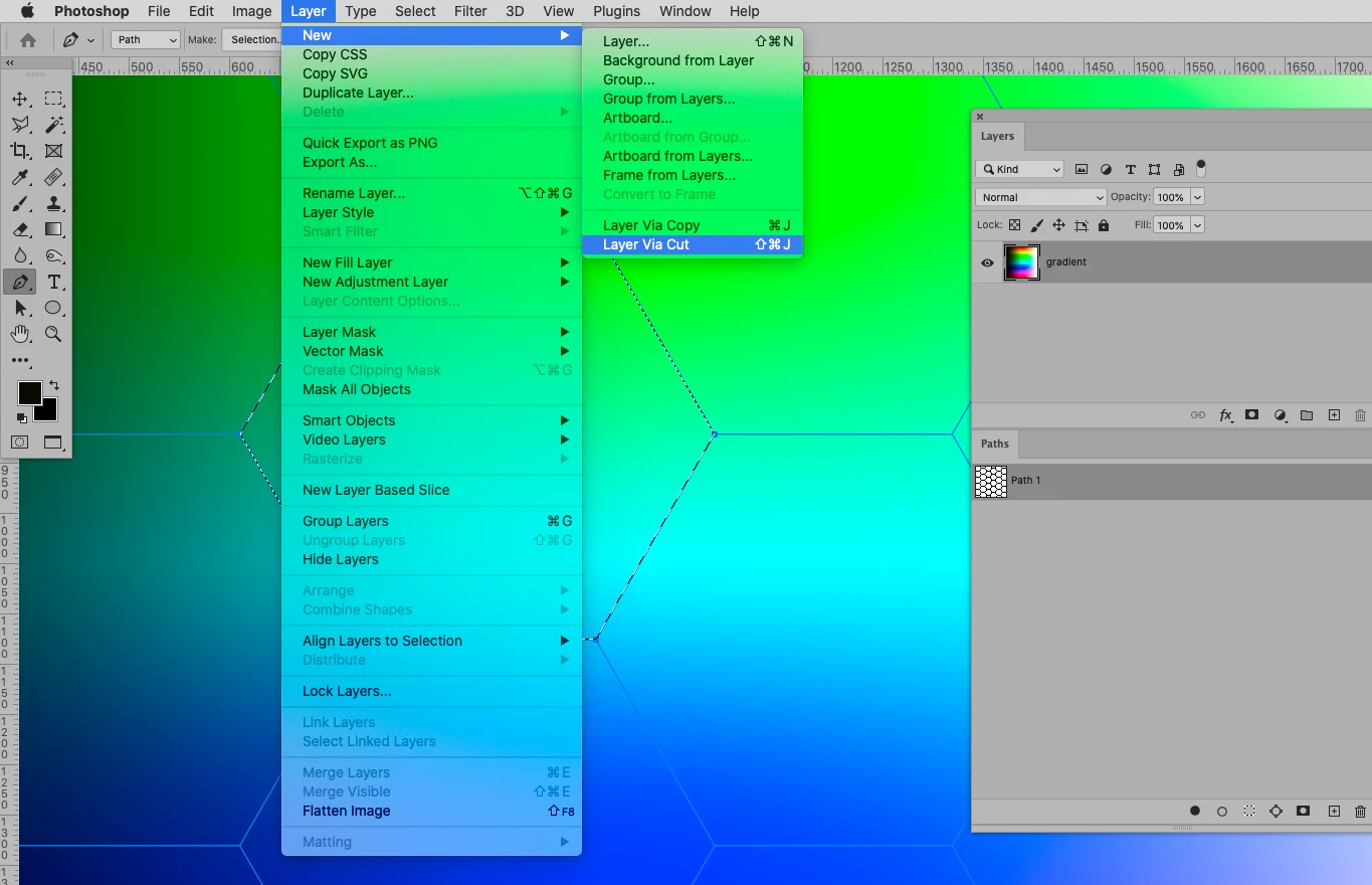

You could use the Polygon and convert the path to a selection.

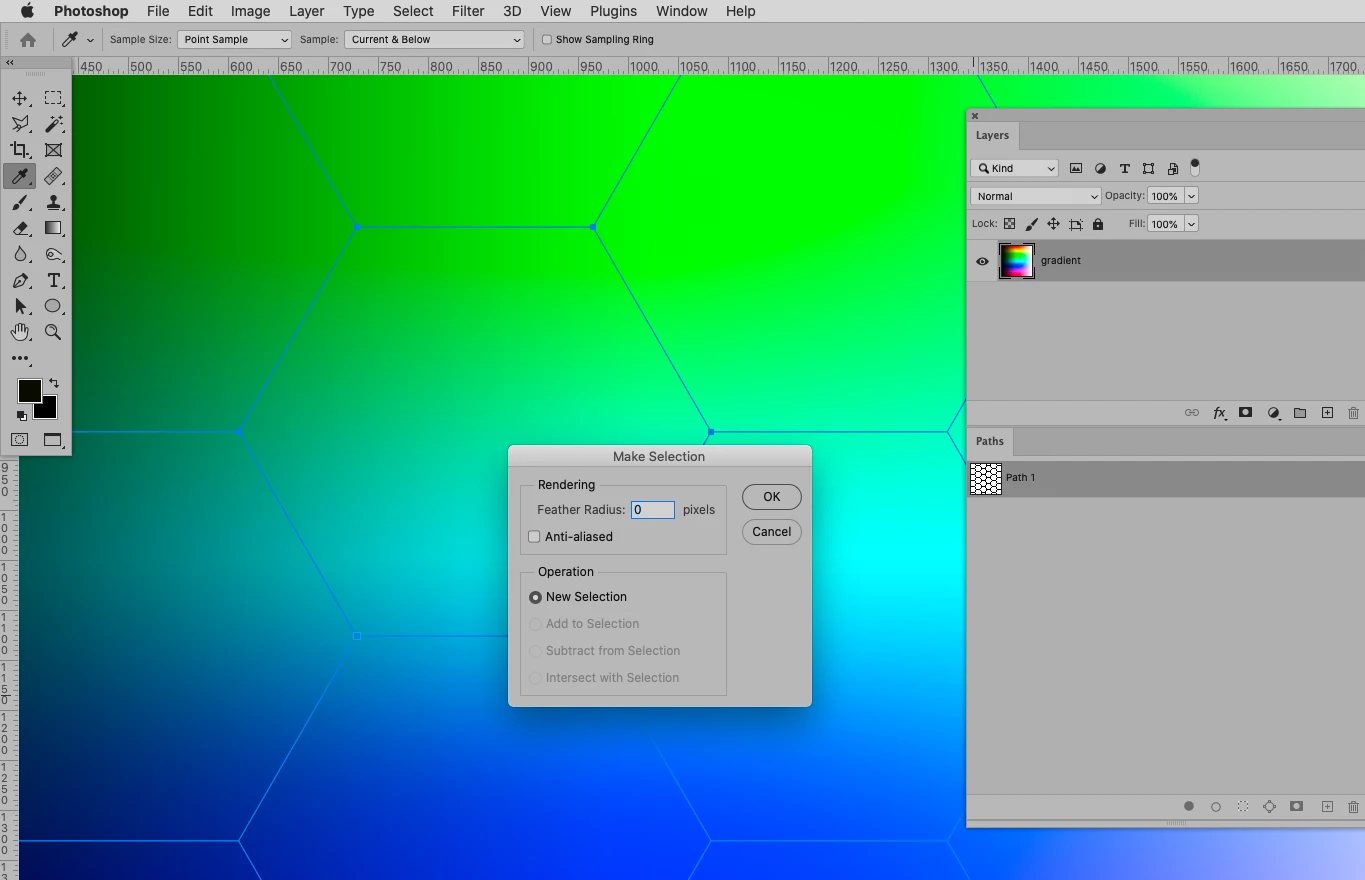

I guess starting with hexagonal paths and using them to create Selections without Anti-aliasing would offer an option.

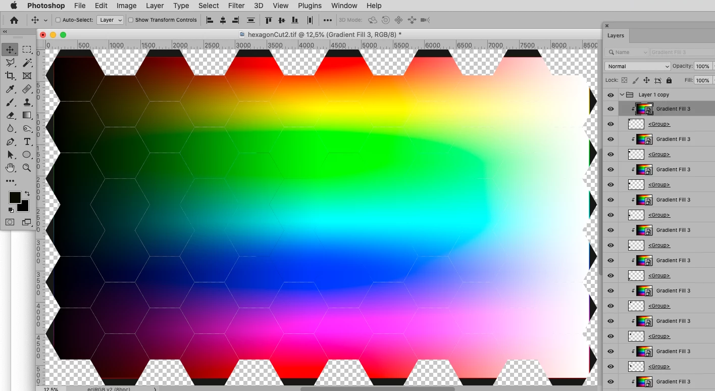

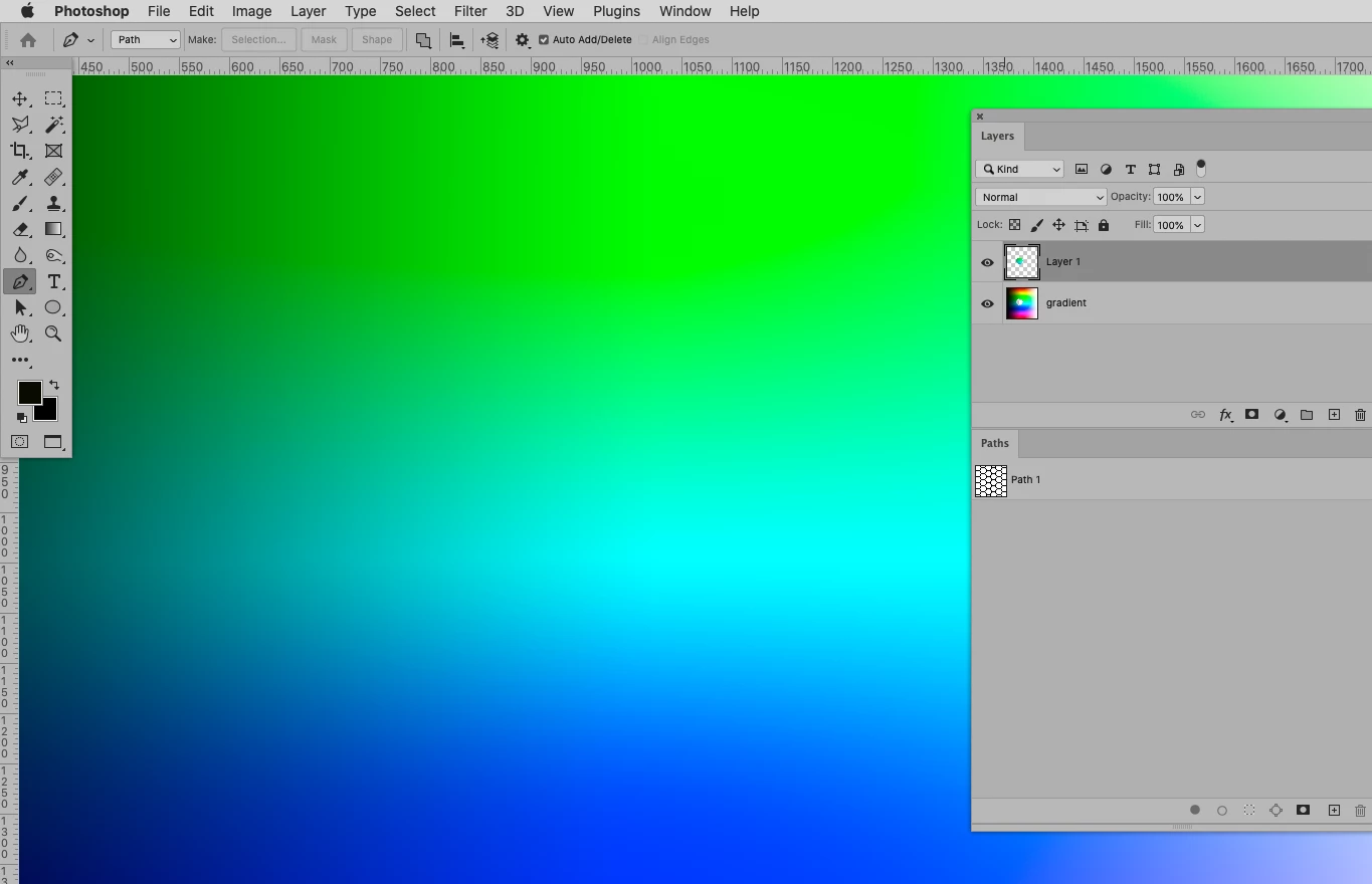

As the third screenshot shows the two Layers match »perfectly« if the Cut is based on a non-Anti-aliased and non-feathered edges.
Depending on the number of hexagons the task may be tiresome to be done manually so if the task is a frequent one a Script might be worth the effort.
