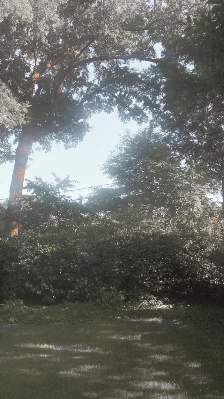

I have a Snapchat filter I like and I'm trying to determine what exact editing the filter adds (contrast, highlights, color hues, etc.). I assume the lens uses a color LUT, Is there a way of finding out what this filter adds to pictures? Any techniques or ways of determining this?
I've attached two pictures: one with no filter, and another with the filter I'm trying to recreate.

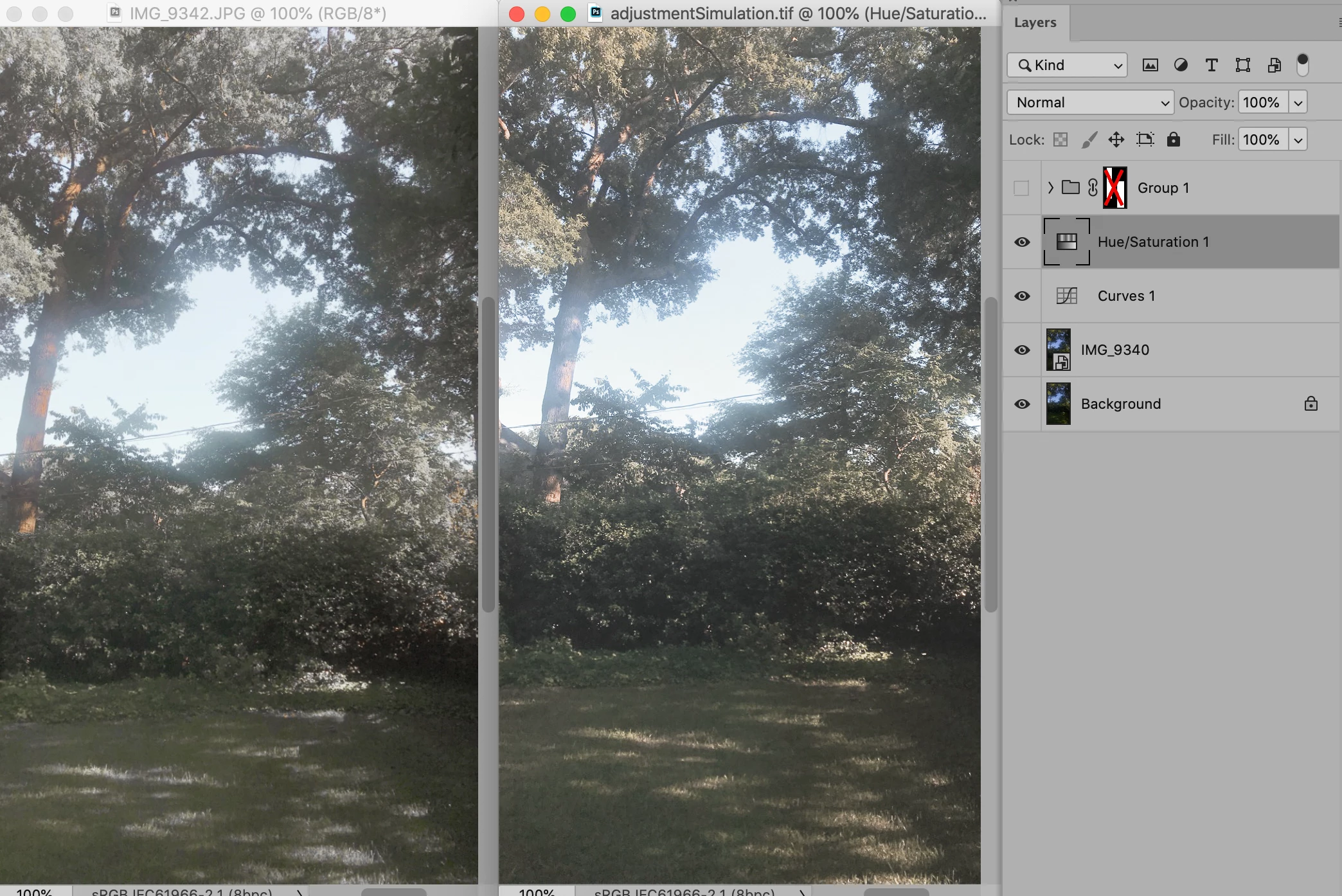

The two images are apparently not based on the same source material.
A rough approximation seems possible with two Adjustment Layers (Curves and Hue/Saturation).
Photoshop terminology may be a bit of a problem here:
Several of the Adjustments can be applied as Smart Filters, but they are not usually called »Filters« because they work pixel-by-pixel whereas the »proper« Filters can (though not all do) calculate the result for a pixel based on a number of other pixels.
