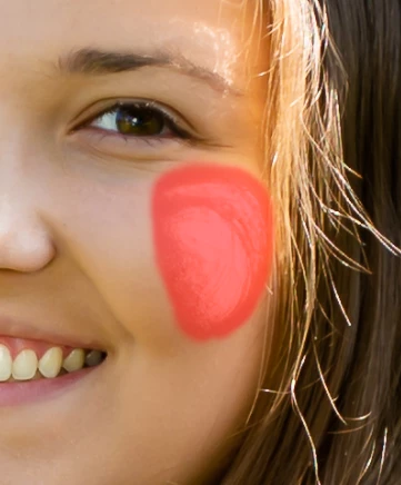

Hit the 'Q' key to enter Quickmask,  and paint over the problem area with black (it will show as red)  [See note below]
Overlap the area a wee bit.  Something like this

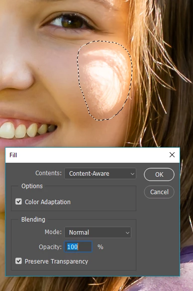

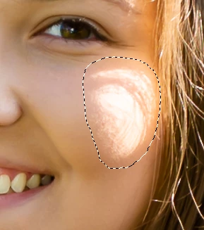

Hit  the Q  key again to come out of quick mask
And use Edit > Fill > Content Aware Fill

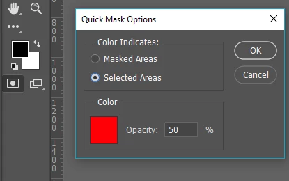

Note: The default  for Quick Mask is Color Indicates Masked Areas.
I prefer  to use Selected Areas
