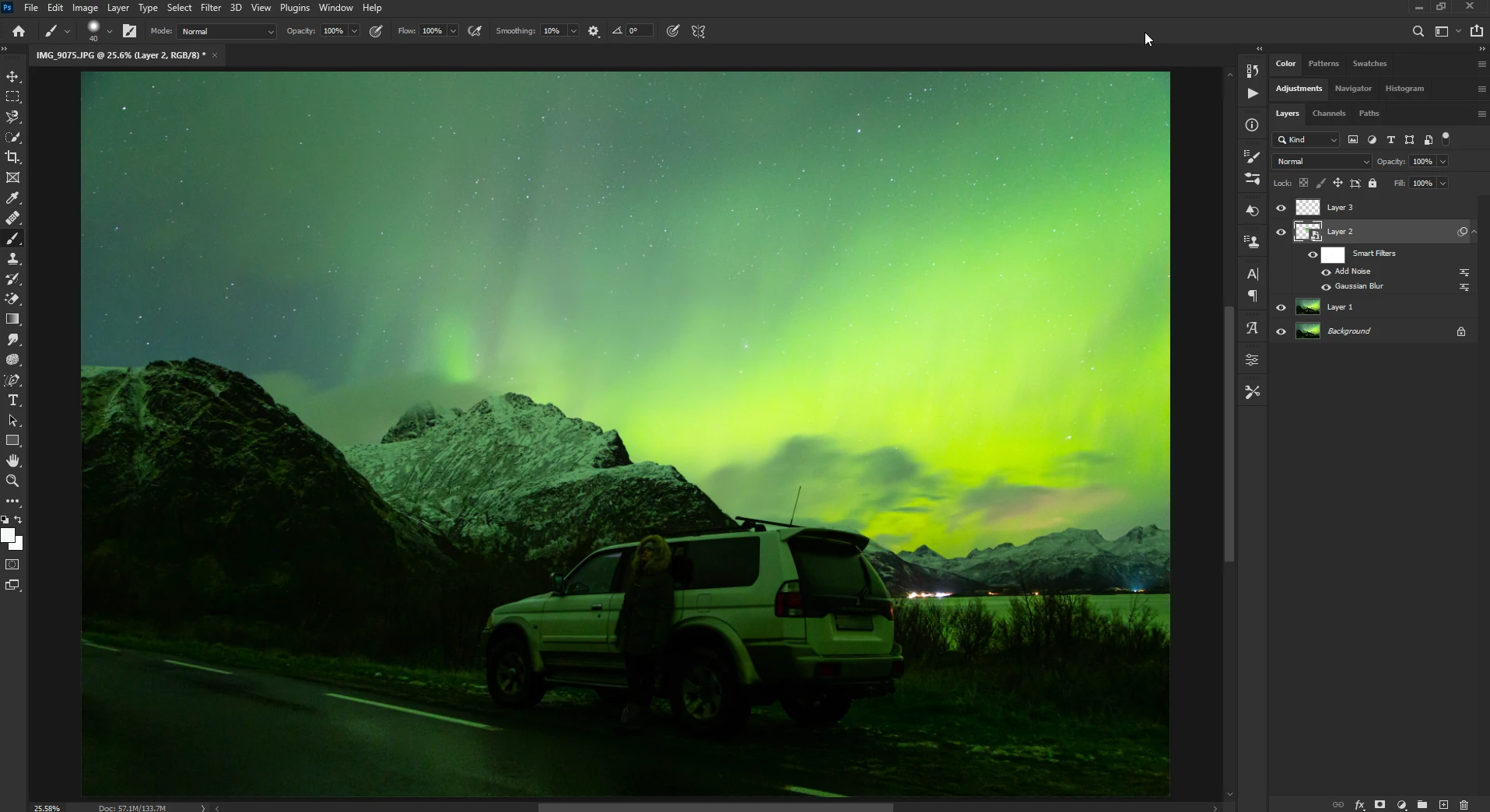

Hi
You could make a selection of the affected area and copy it to it's own layer, convert it to a smart object, then add a gaussian blur and after that add some noise, on a new layer paint back in the stars

Thank you so much, everyone, I keep playing with all these options to see which one comes up with the best results but it looks all better already. Gaussian blur + add noise is interesting! Thank you for help!

Hi
