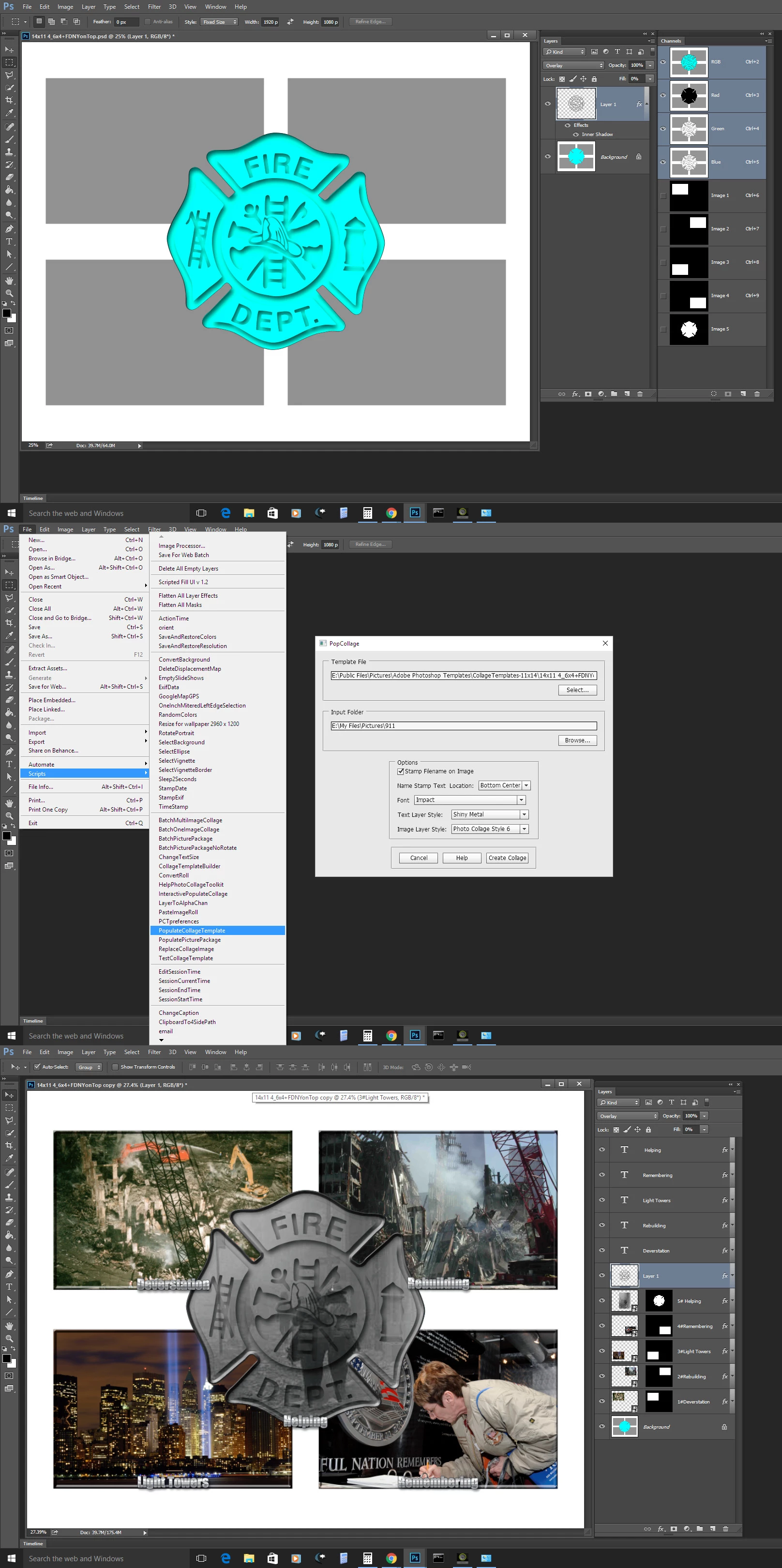

I know no French so your better them me I have to use English my native tong but I failed every English class I had to take in school.
It sounds like your doing the replacement  and because your replacing the smart object layer's object the filename of the replacement is lost in the shuffle.
If you were to automate the process with a script. The script would have access to that filename and could name the file it save and include that name.
I do not have a script that replaced smart object layer's objects because all replacement need to be the same size and resolution as the original template object. I prefer to be able to handle and size image.
I created a template from your template that would work with my batch script.  Because I do not use replace layer content I can not attach smart filter to image layers. I do place in images but would not know how to adjust a smart filter for the layer content. All my scripts can do is add layer styles to image layers.  However a demo of my script will show you the a script would have no prone creating the file mane you would want.

JJMack
November 20, 2015
In your template if you Ctrl|CMD+click on your Pillow Layer's Layer Content Icon in the layers palette that will select the Pillow pixels. You then use menu Select>Save Selection,,,  Then in the save selection dialog you save in the current document a new channel and name it "Image 1".
It would also be possible to eliminate your shadows layers.  You could create a Layer Style the coul add those effects.   You need the Pillow layer to blend in the pillow texture and shadows. If you downloaded  my Photo Collage Toolkit you can add additional Layer Styles to the toolkit's preferences script.  The script is use by all the Collage populating scripts.
If you look at the video you will see I used a layer that is 50% gray with a layer style to overlay an image layer and burn the NYFD logo into the image. In my template the color did not hav to be 50% gray for I set the fill to 0. The layer was as shape layer I rasterized to reduce the psd file size. Additionally you can Layer styles to image layers and text layer the script add populating the collage.  Image can be stamped with the file name in on of 9 locations over the images.  If the collage is being populates is a single image collage you can stamp the filename on the image or on the collage.
