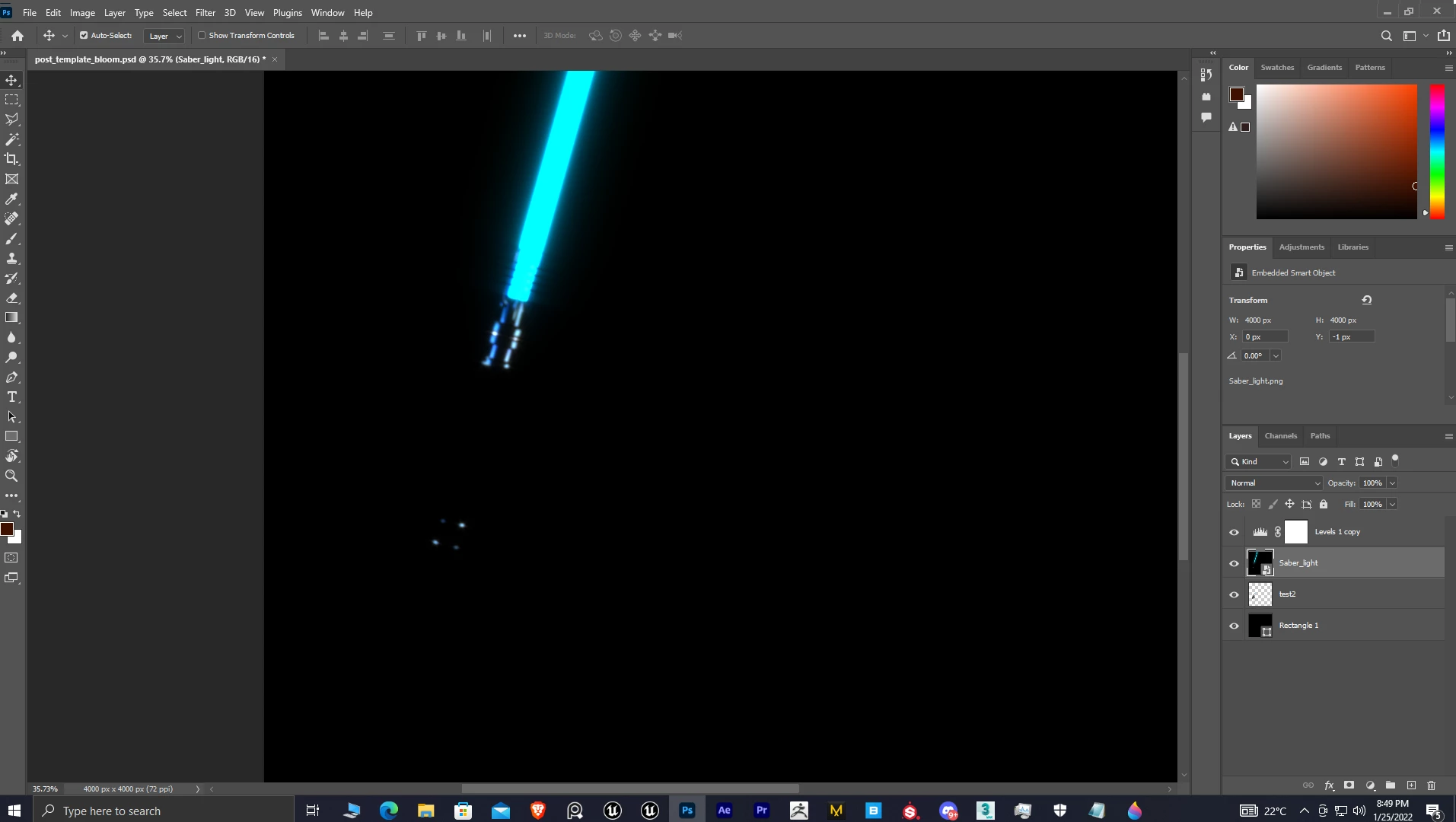

Here is a few screens to better explain my situation
 So the image ebove is the glare and gloom form a light saber I rendered in vray and saved it as a png without an alpha

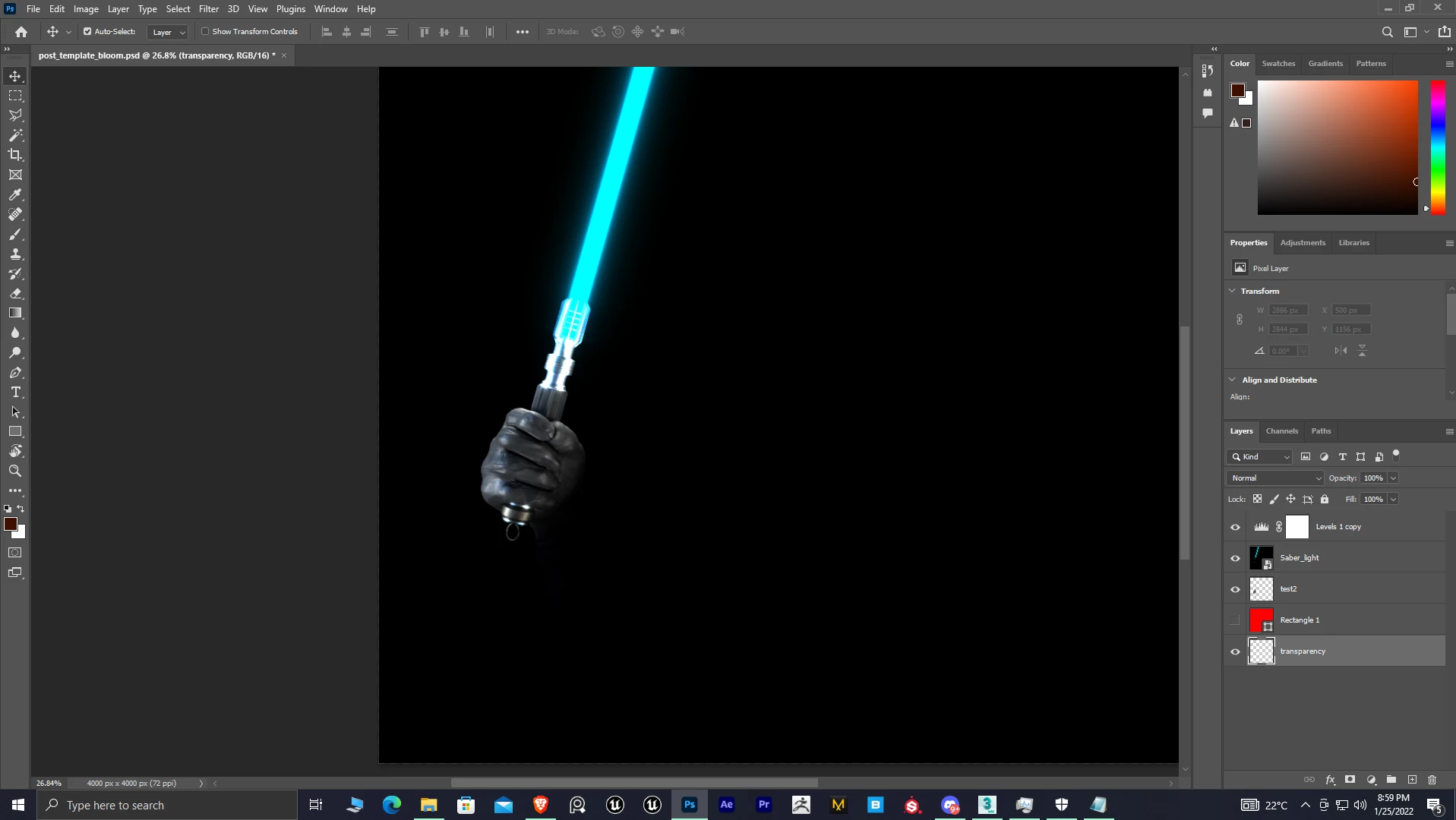

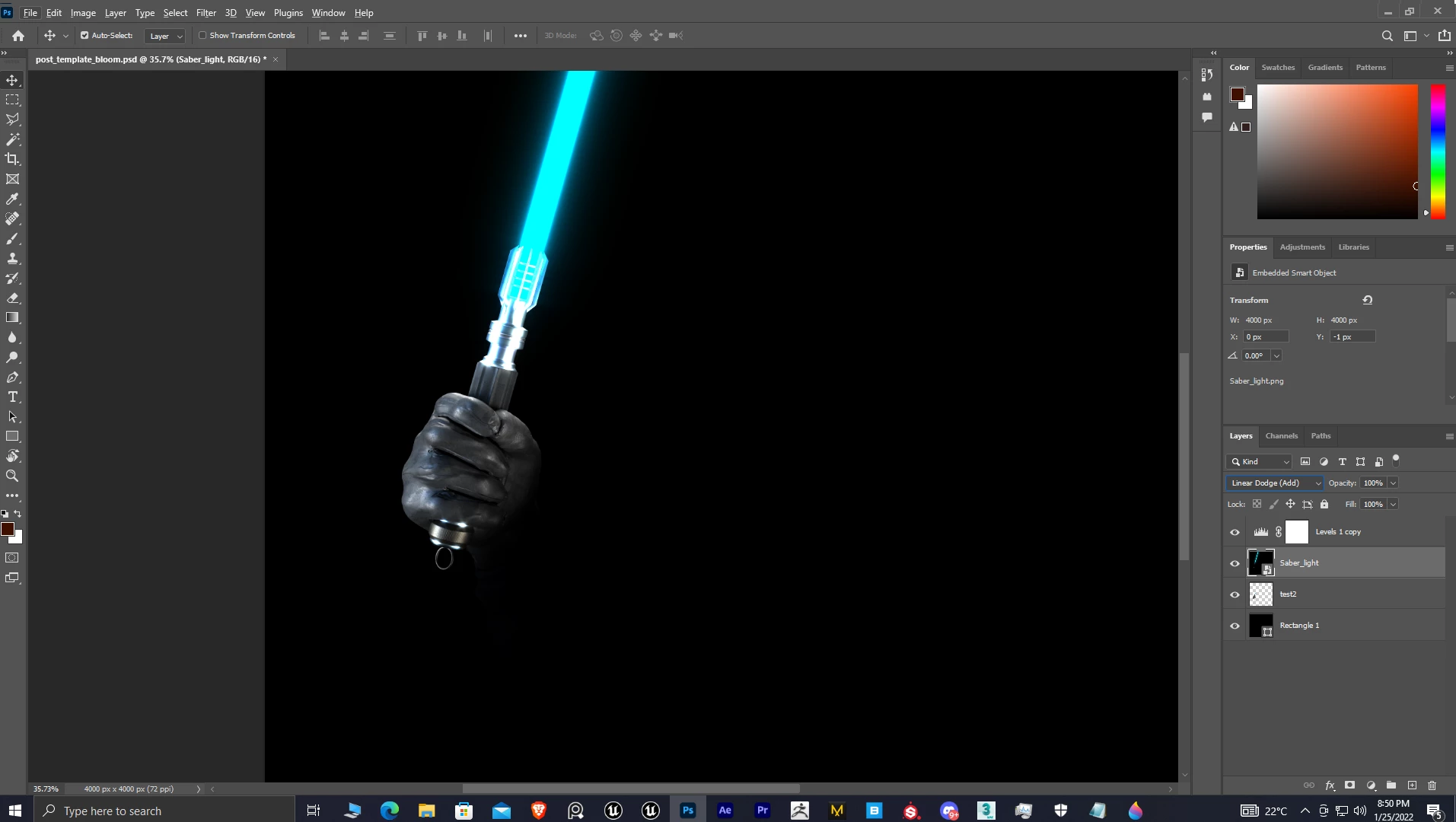

 This is when I blended the layer as linear dodge [note how it acts kinda like a transparent layer above the other layers due to the fact that you can see the layer below]
 You can even change the backghround layer and the "blended layer still works and acts like a transparent layer, but when i remove the background it displays the defualt background it was rendered on but still blends with the other layers below it
 The reason it does this makes sense to me because there is no background layer to blend it on, but what im asking is, is there a way to capture the final effect from a blending layer and export it witout the black background ?

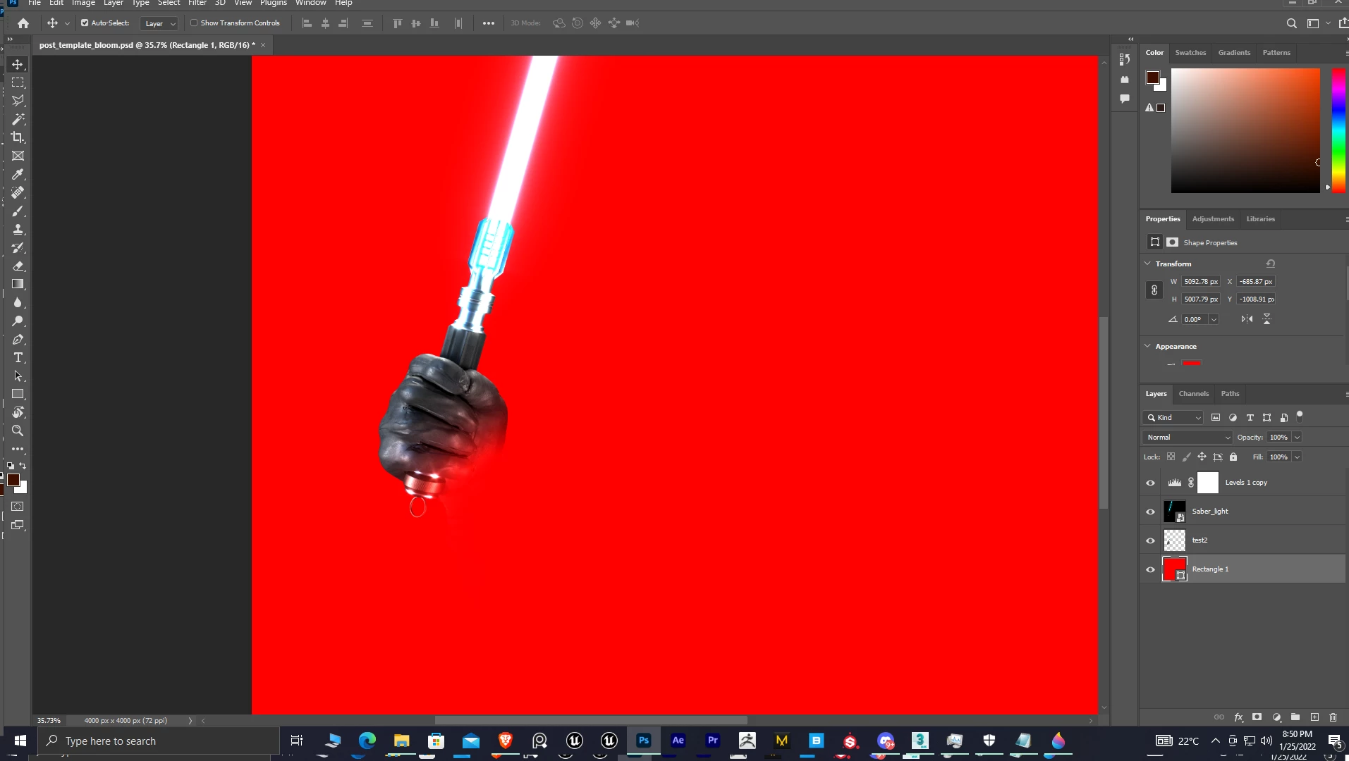

No, as the effect depends on the underlying values there is no unequivocal corresponding transparency that would achieve the same effect.
Set above a red layer the »blade« appears white, against a black background it appears cyan – that seems too much to expect from one Layer with Blend Mode Normal and Transparency.
