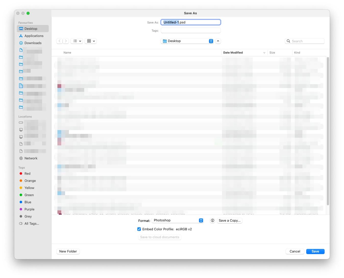

Are you thinking of one of the different ways to save a JPEG - not Save As ?
c.pfaffenbichler
July 5, 2023
quote
When you bring up the "Save As" dialog box in Photoshop, it gives you the option to save the Photoshop document as a smaller file size.
I fail to see that option in the Save As-dialog.
Could you elaborate and post screenshots to illustrate?

July 5, 2023
I meant Export As, not Save As.
Here's what I ended up doing: I just took the Photoshop Smart Object documents used in this workflow and downsized them to 1000x1000px (the final desired image size anyway). I then just applied 6/12 for the image quality settings to compress the image to get a smaller file size with a marginal visual quality reduction. I may have misremembered some earlier problems I was having with image size + distortions related to Smart Objects, because when testing the final JPEG images of the 1000x1000 vs the original 2000x2000 or 4000x4000, I saw no discernable differences in image quality.
