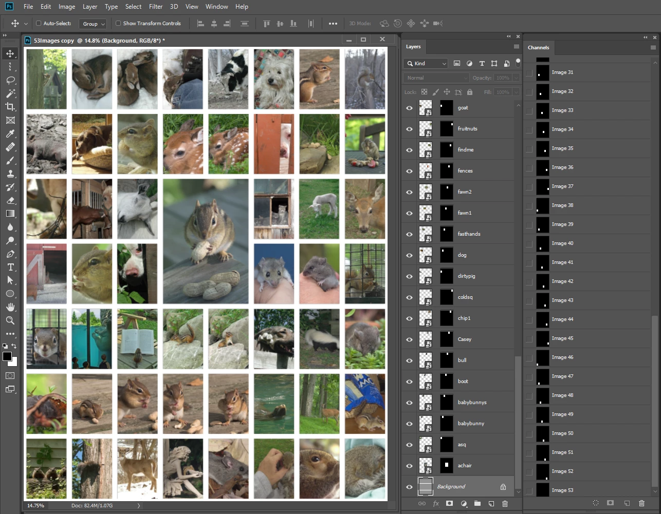

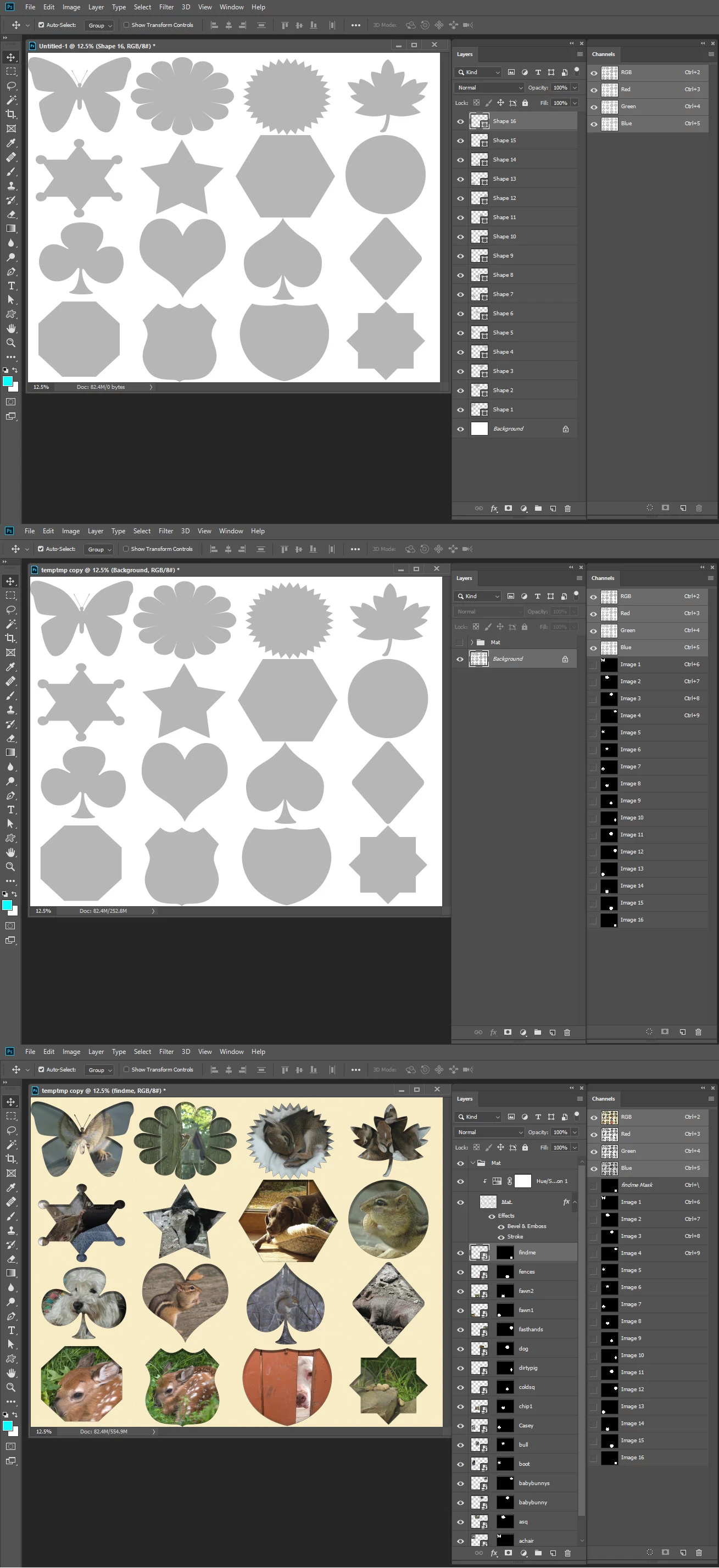

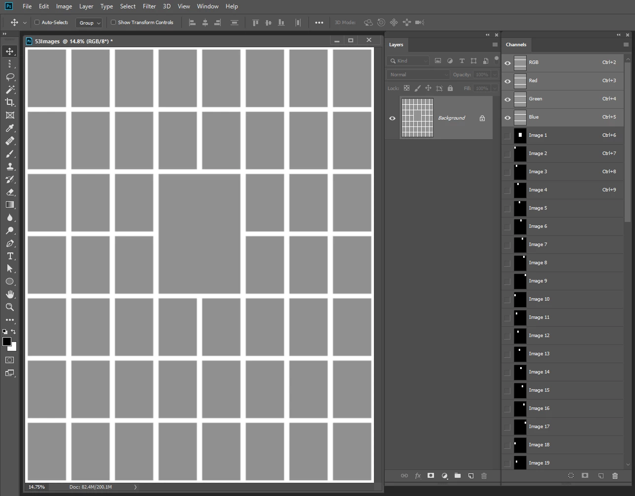

You would need to design the the process you want to use and code the script.  For example if I want to create a collage template that would looks like a pile of 4" x 6" images  were toss randomly on a table I may prototype that collage  Create a document the size I want the collage to be.  Create a 4x6 Layer and duplicate it x number if time where x is 53 or less.  The scatter layers over the canvas.  I would then runs  my script that  would convert the prototype collage into an actual template document.  Create Alpha channels for each image layer and merge all the layers into the background.  The problem is my Collage populating scripts do not support rotating image they place in.  That I have to do manually after the image are populated.  So  I would be more likely scatter some shape layer so place in images would have different shapes  I would not add rotation when I distribute the shape layers. The collaget will look like the dhaped image were carfully layer out one the canvas.

Create a new document named FutureUseMasks then duplicate the layer with layer mask you want to use in the future into that new document then Save as a PSD your layered document named FutureUseMask.PSD
If you have 53 or less Layer mask you could save a document that only has a background layer and up to 53 named Alpha Channels look like one of my Photo Collage template PSD files
