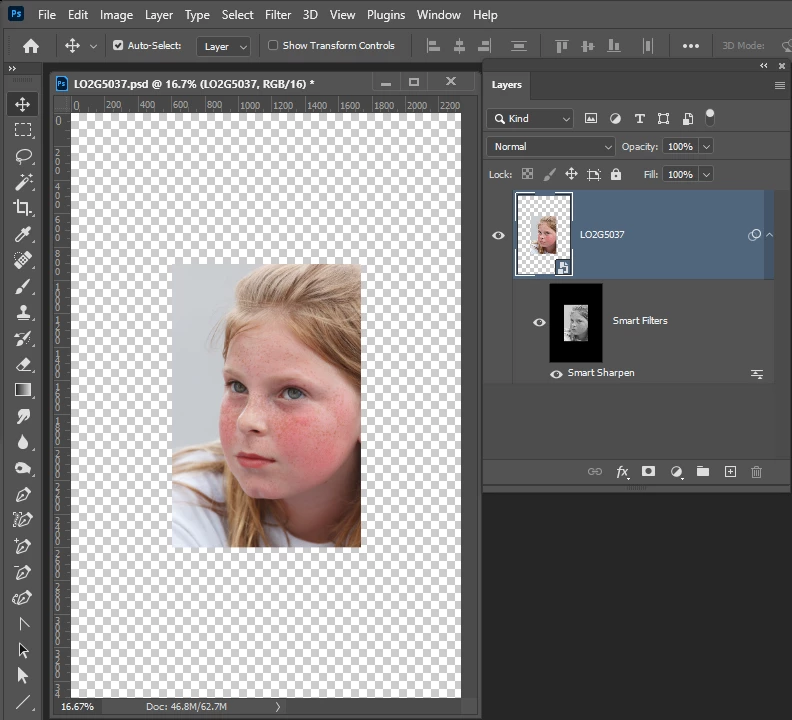

JJMack
June 2, 2021
If there is a Smart Filter mask involved that is not all white you may need to scale of the mask to match the smart object scaling you changed. The filter mask would have  been created for the prior object scaling. Filter are not scaled  however they can be masked.  All smart filters on a smart object layer share a single filter mask. Here you can clearly see the smart filter mask did not scale when I changed the smart object layer scaling.

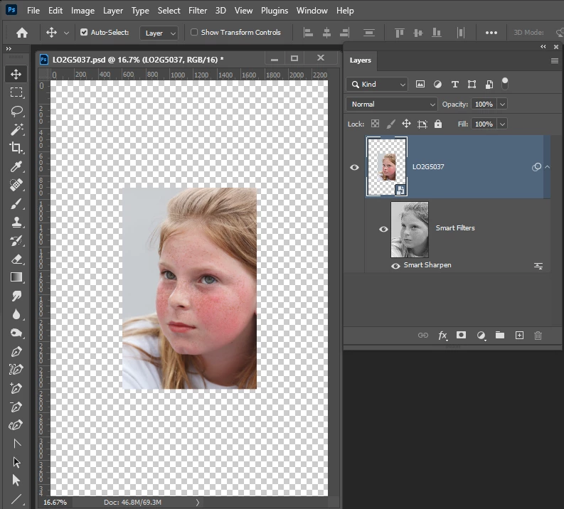

However I was able to scale the Filter mask to match.
