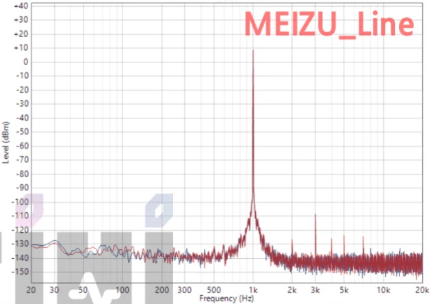

I have an 8Bit RGB image with a background in grayscale and a subject in color. I want to select every pixel that is not grayscale.
I know of photoshop's tools for subject selection as well as the color range selection tool, but those do not give me a satisfying result with my particular image.
Any help would be greatly appreciated.

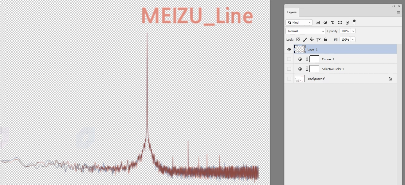

An alternative method of achieving what you need is to make a saturation map and then make a selection from that map. A saturation map is black where R=G=B and gets lighter the more saturated the pixels (i.e. the more R does not equal G does not equal B)
1. To make the saturation map, add a selective color adjustment layer.
Go through each colour in the adjustment properties and for each colour turn the black slider value to -100%. For the three neutrals i.e blacks, neutrals and whites turn the black slider to +100%
Click the "absolute" button
You will now have the saturation map
2. You can add a curve above this map to increase the contrast
3. Click on any channel and make a selection from that channel
You now have all pixels where R does not equal G does not equal B selected. You can turn off visibility of the Selective colour adjustment layer and the curve and use your selection to copy the required area onto a separate layer
Dave
Norman Sanders
March 21, 2021
Dave, I had trouble following your instructions (my fault) but I am dazzled by your result. Fantastic!

staticV3Author
March 20, 2021
Here's the image in question:
https://drive.google.com/file/d/1LJnB23EYz6BKmKPWsrVCuPxiQggBmFJc/view?usp=sharing
Essentially, I want to isolate the graphs from the coordinate grid they're on.
