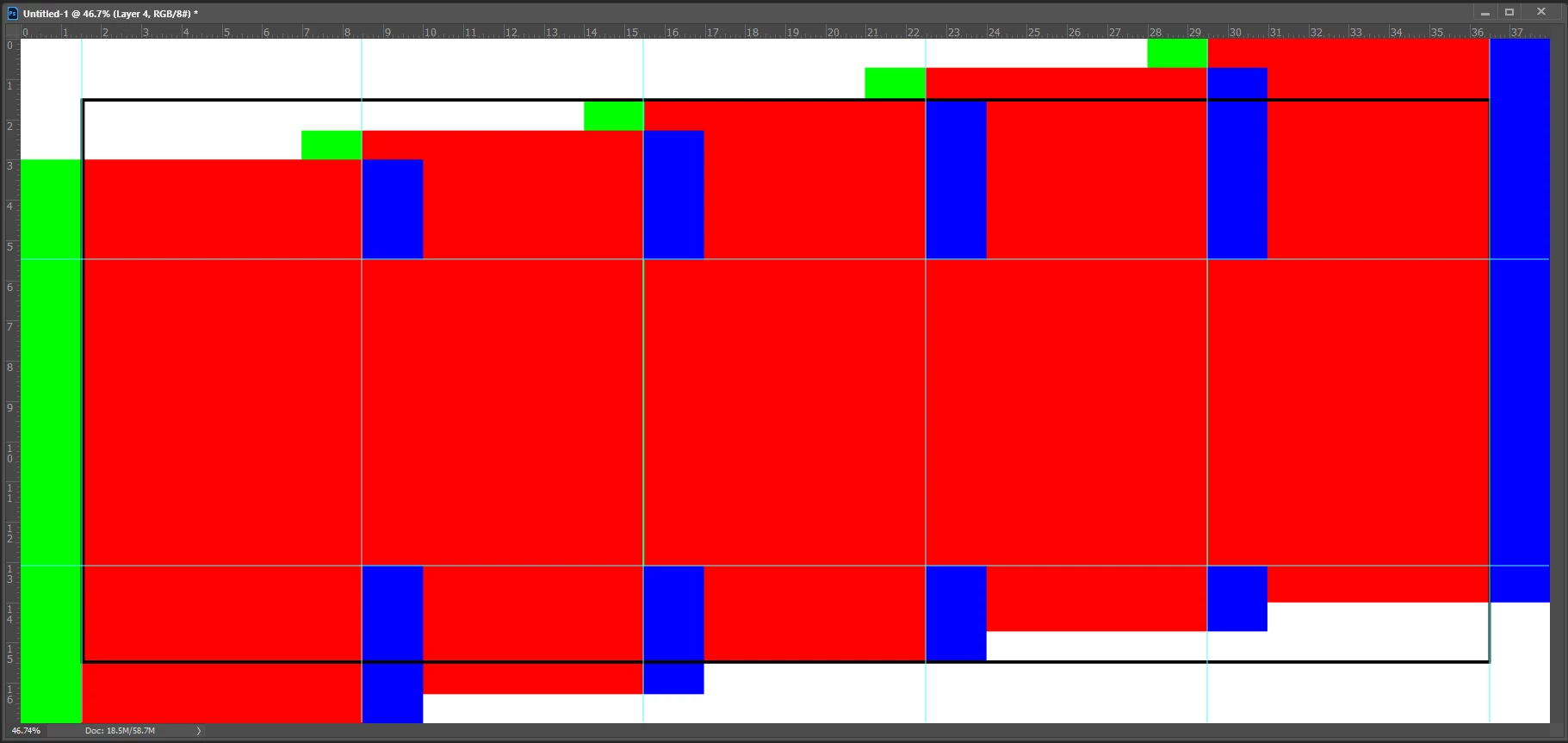

So far I do not see mention that your pieces must contain one small but exactly the same part of the image for overlap, if I can understand your question correctly.
You must divide image into 5 equal parts using guides what is easy solution. Then drag guides on both side of guide divider which should be spaced 0.75 in on both sides to have final 1.5 in overlap. The next step is to select portion or pieces which has 0.75 in on both sides as extension and to copy that portion on new layer. repeat operation for all 5 pieces. I am not sure why you need extra canvas? Anyway you already have explanation for that although it will complicate task and math to solve puzzle.
Here is what I mean:

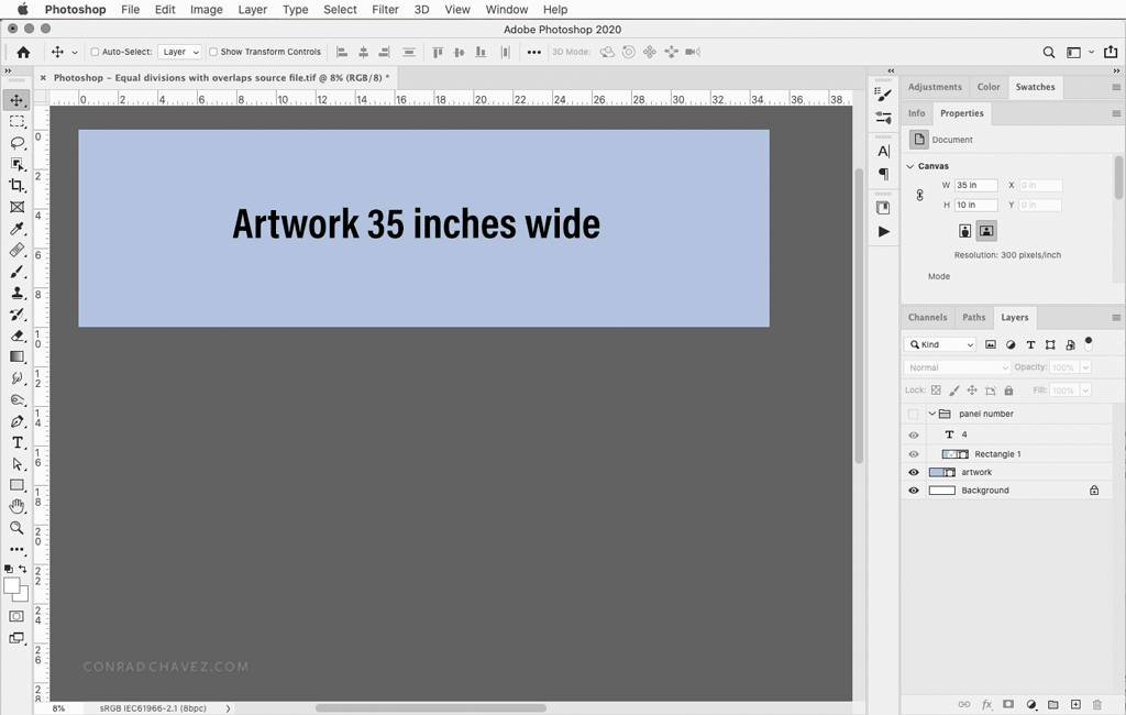

Have you tried using the Guide Layout feature to have Photoshop do a lot of the division math for you, as in the animation below?
If I understand what you’re doing, the artwork not only needs a 1.5 inch overlap between panels, but 1.5 inches of extra canvas around the entire artwork for the stretcher bars. If so, then the first step is to extend the Photoshop canvas beyond the artwork, also shown below.

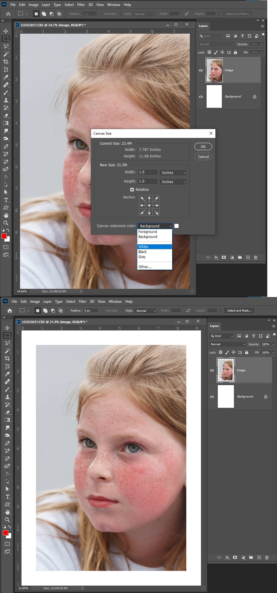

Yes, that’s what I would suggest. I’ve run into the same thing where I wanted to canvas wrap a print, but important parts of the image content were so close to the edge that they would have ended up on the side or back if I had wrapped the image edge itself. And I didn’t want a white wraparound color either. So I used the same idea you just mentioned. After expanding the canvas to provide overlap, I drew a big rectangle shape all the way out to the new expanded wrap edge, filled it with a solid color sampled from the image, and layered that behind the image.
The other way to do it, which sounds like the direction you were going in, is to set the background color to whatever you want, then when you go into Canvas Size you can set that as the Canvas Extension Color.
Either way, it’s the same as in the animation except with a color other than white in the canvas area around the artwork.

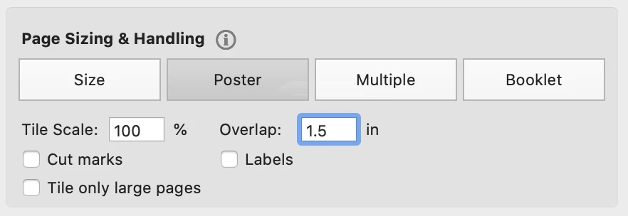

Photoshop does not have Tiling as an option in the Print dialog, as InDesign, Illustrator, and Acrobat all do. The easiest solution is to print your image as a Photoshop PDF, then open it in Adobe Acrobat or the free Reader. Choose Poster for Page Size and Handling, then type 1.5 inches for the overlap.
~ Jane
