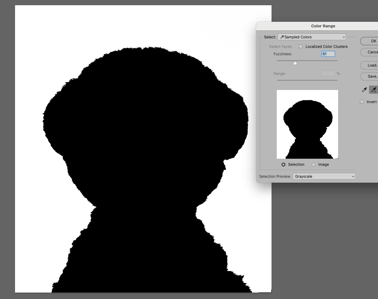

Then I used Color Range to select the outside area:
After I had my selection, I feathered it by 3 pixels and sampled the yellow color at the top of the image, and on a duplicate image, I used the Fill with Foreground Color (Option+Delete) to fill the area and get rid of the shadow at the bottom.
