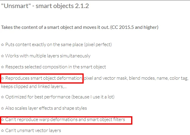

In some cases using the action manager, you can edit the contents of a smart object without opening it (in particular, access the layers inside it) - unsmart script of  Jaroslav Bereza

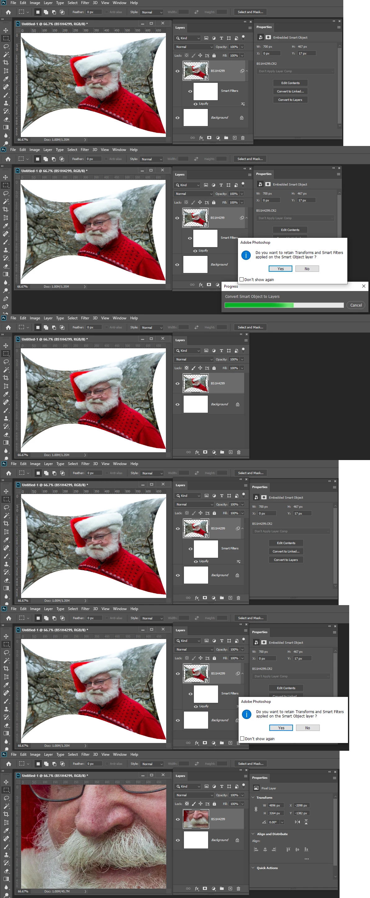

That seems replace the smart object layer with other layers and it can not had distortion and smart filters. Therefore, Replace Content and Opening and Editing the object will work better.  For on one of mains reason for using smart objects in templates is they have support  distorting images via the smart object  layer's associated transform witch includes sizing, rotation, perspective and warping.  And adjustment with smart filters. Its discription even confuses me.
Also Photoshop placeLayerConvertToLayers will be like rasterize layer if you want to keep the visual effects of warping and filtering or remove all warping and filtering.   You can not convert back to a simular smart object layer.
