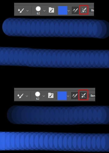

    Fenja: That option you're referring to only turns on/off "clean brush after each strok". It only appears to work after you've used the brush for a while.

    There is an effect, but it is not that you are mixing with white it is that you are not mixing with anything therefore the brush starts with 100% of the paint colour that is loaded on the brush, whereas starting on the canvas it starts by mixing with black.
    I have shown two sets of three strokes below. The first set is a straight stroke , the second is a "zig zag".  In each set, the first started off canvas, the second started and finished in the black the third started in the white patch. You can see that starting off canvas is not the same as starting in white - but nor is it the same as starting in the black.
    To get round the problem  - extend the canvas temporarily so you are starting in the background colour rather than off canvas - then, once done, crop it.
    Dave

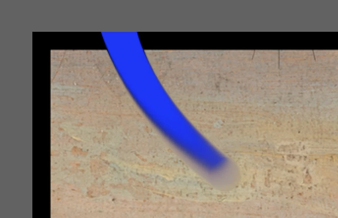

    What you describe is, as far as I can tell, not normal Photoshop behavior.
    Here's a black canvas and a blue brushstroke started outside the canvas. The gray is the pasteboard:
    November 6, 2017
    How dark was your blue color? It looks bright to me, as if it did indeed "pick up" the white color beyond the canvas.
    I'm not using some sort of special/modified version of Photoshop with different behaviour...
