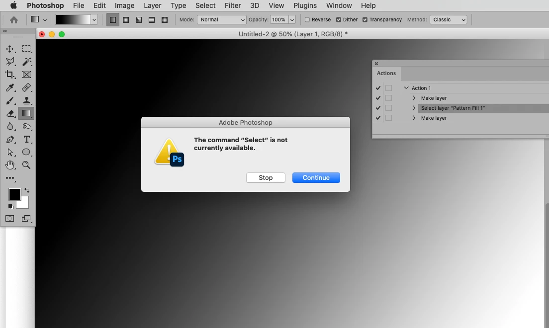

I'm new to Photoshop and have been experimenting with actions that I have downloaded from the net.
One of the problems I have run into is that if the result looks odd, it is not clear whether the action has completed successfully. How do I tell when an action is properly completed?
In one case it stops and the cursor has changed to a 'not-allowed' cursor - presumably in this case it has failed in some way?
That need not have anything to do with the Action.
Could you please post screenshots with the pertinent Panels (Toolbar, Layers, expanded Action in Actions Panel, Options Bar, …) visible?
Just keep an eye on the expanded Actions in the Actions Panel; if an Action actually fails you should get an alert, though.

How is that? All the steps look the same.
c.pfaffenbichler
November 18, 2021
Except the one where the error occurred, that one is highlighted …
