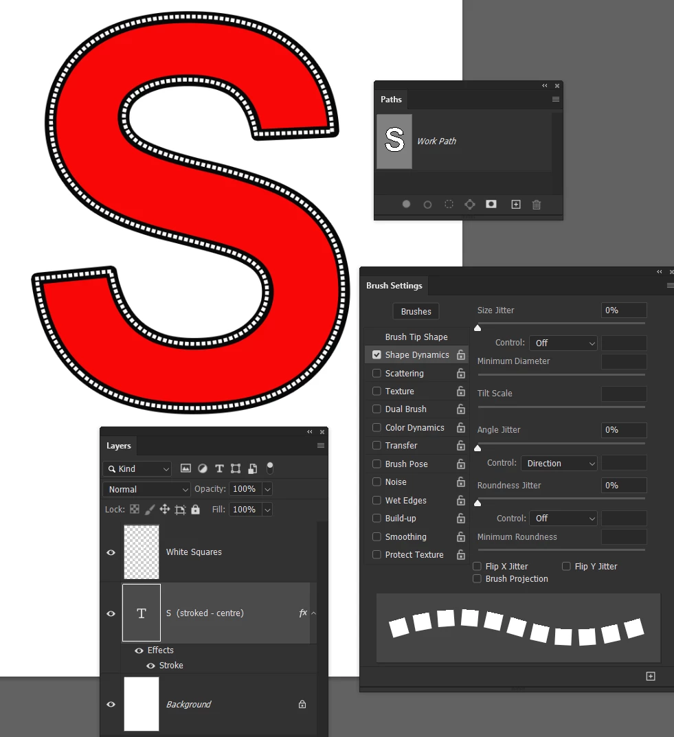

I started out trying to wark a film strip to the shape of the S, but it was not going to be accurate.
Then I tried making a brush preset with a black rectangle with the square holes, spaced to fit and set angle jitter to Direction.  That was not nice either.
So this is what I went with:
Made the S on a type layer.
Stroked it with black set to Centre.
Used Type > Create Workpath  This does not change the type layer.  Just makes the path.
You can see why the stroke had to be set to Centre.
Found a square brush preset and increased spacing, set angle jitter to Angle and stroked the path.
The ends will be easy to fix, or you could edit the path before stroking it.

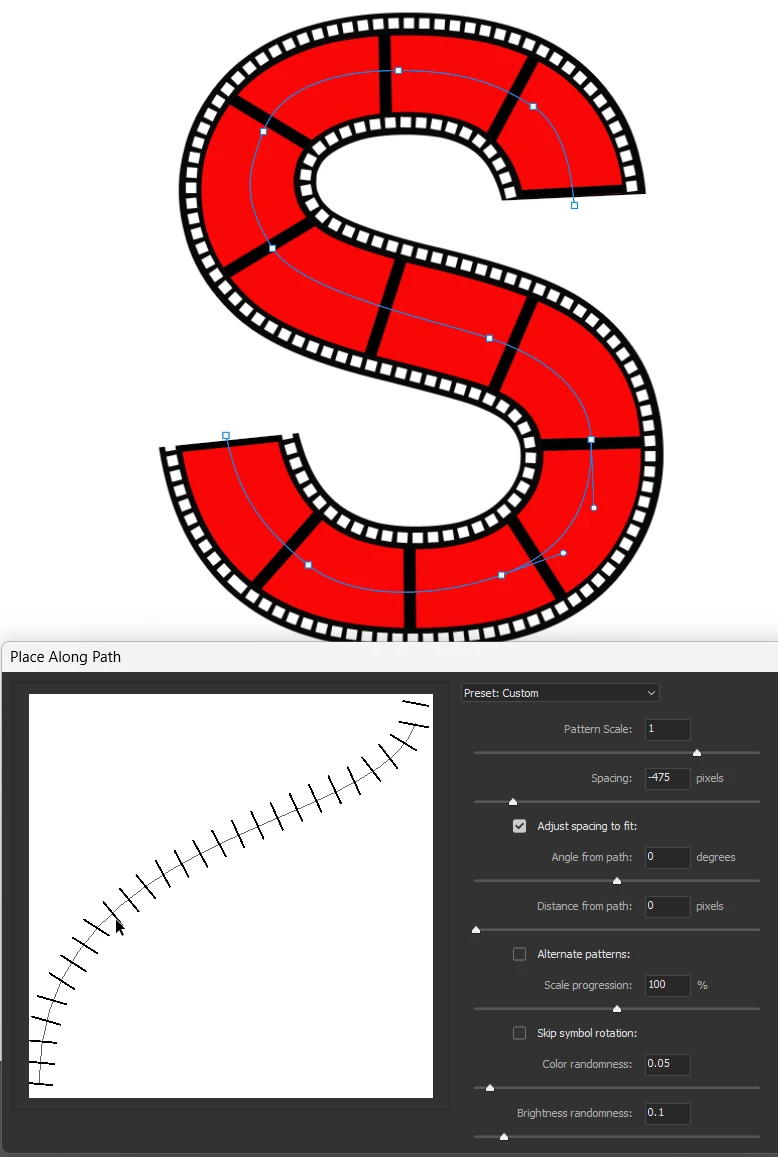

I've actually run into a problem here. I've used the same method to add the frame breaks, but with space all the way to 100%, the lines are too close.  I added the path manually, as it is not crucial.  It's more top distribute the lines equally.  I made the lines longer than they needed to be and clipped to the S type layer again.  I can't remember if objects on a Path will let me angle them perpendicular to the path.
Trevor.Dennis
Apr 1, 2025 9:10 AM UTC

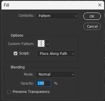

OK, I worked it out using Objects on a Path.  It took me a couple of goes to get the pattern right.
This is a 1000 x 1000 pixel canvas.
Edit > Fill > Pattern > Place along a path.

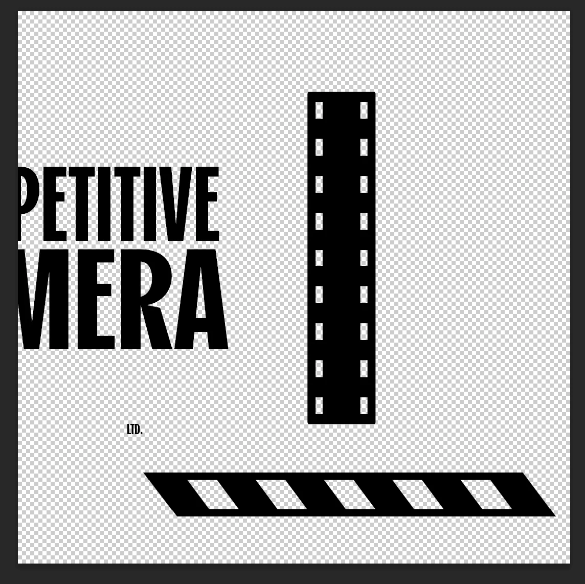

I have two options for film strips, one I downloaded and one I created. Like your image above, I would like one of these to follow the S line. I would prefer the first iteration, but it would be nice to know how you simulated the bending film as well.
