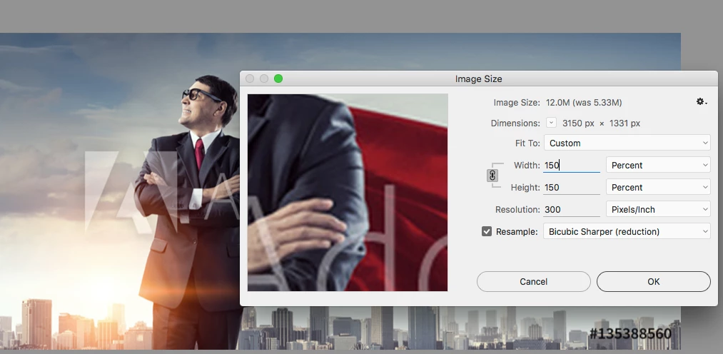

mglush
February 28, 2019
I have had really good results by using the Image Size command (Cmd-Option-I), setting the drop down menu next to the Width and Height to Percent and using a value of 150%. I will then repeat it until I get the desired height or width.
I agree with the suggestion above, that the first thing you should do is talk with whoever will be printing this for you to see what resolution they need. If it is a video wall, the resolution will be a fixed number and not a multiple of pixels per inch. It's always important to know the end goal of your resolution when you start.
mglush
February 28, 2019
Here is the Image size dialog box so you can see the settings.
Let us know if you have any questions!
