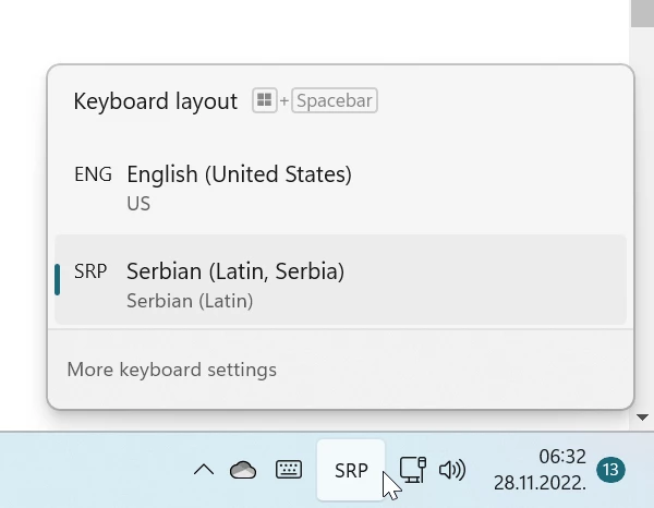

Bojan Živković11378569
November 28, 2022
You can install multiple language packs as I did. My layout (input languages) are Serbian and English. When something wrong or keyboard does not work just press Windows key + Space bar to change input language.
Tilde does not work when input language is set to Serbian but it works when changed to English (United States).
