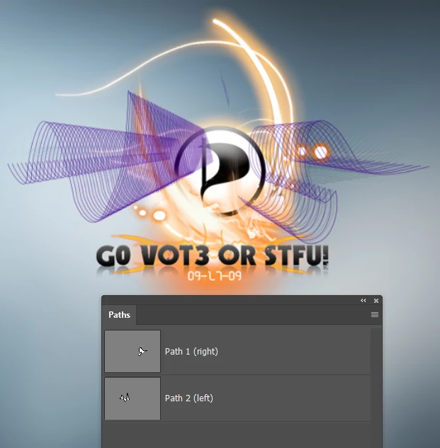

The only possibly tricky part is the background pattern, but I think you could do i t with Free Transform Step & Repeat
You make a path with the cliping tool and stroke the path on a new layer.  I used a one pixel fully hard brush.
Copy the layer (Ctrl J)
Free Transform the copied layer by moving it and reducing its size (in the options bar)
The use Step & Repeat (Shift Ctrl Alt T) as many times as you need.
I just did two paths and it looks like there is at least one more element to the pattern.

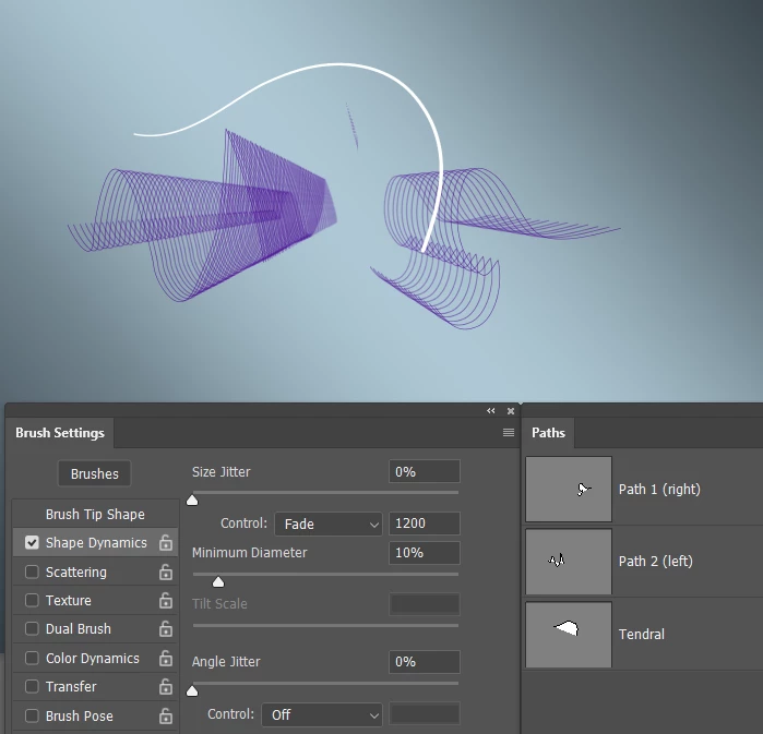

I would use stroked paths for the tendrals as well, but you'd need to use Brush Settings to get the right effect.
I'll use Fade for the long tendral.  The stroke follows the direction the path was made, so you'd need to start from the centre.
Note I have used a simple gradient to make the background and hide the original.
I have started with a fully hard 6 pixel brush and set Size Jitter to Fade with a value of 1200 with brush spacing set to 10%
We didn't want the stroke to tapper all the way to a point so I set minimum Diameter to 10%
It doesn't matter what colour you use, but white wil probably work best.

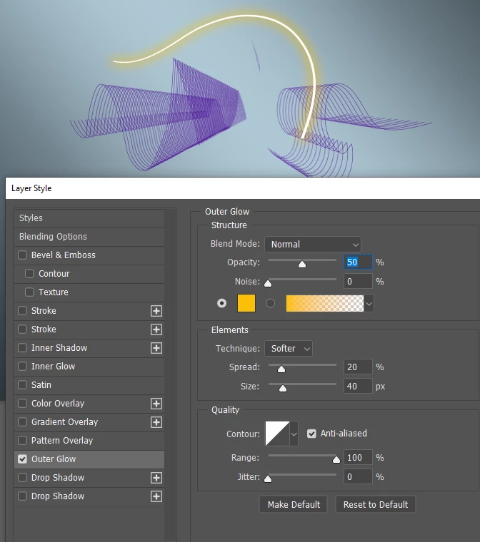

So a simple Layer Style > Outer Glow
