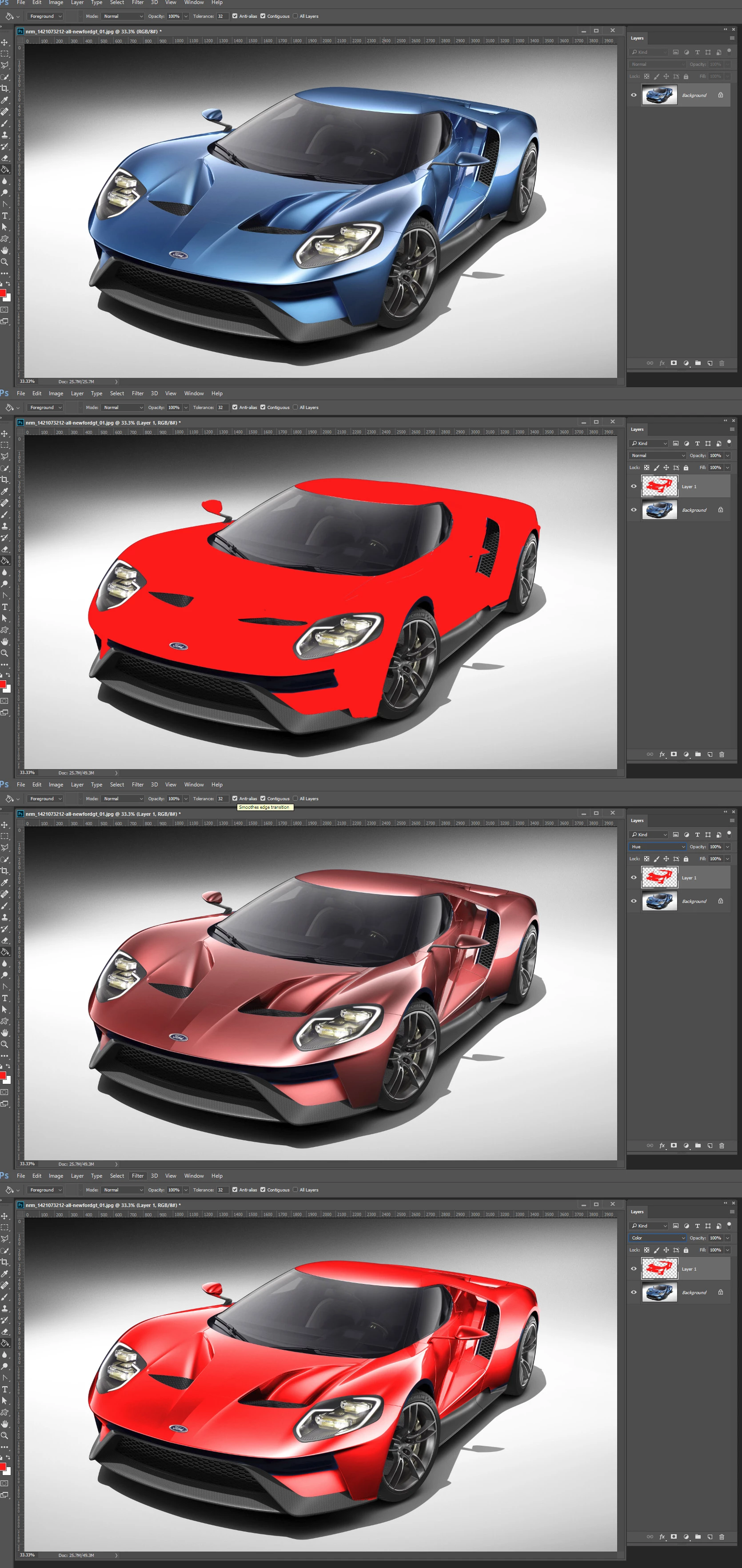

Correct answer JJMack
See if blend mode Color works any better.
November 23, 2016
JMack, thanks so much for your detailed answer. The screenshots were especially great. It's working like a charm!

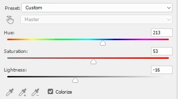

If you want to see how Hue works, rather than a brush,  add a Hue/Saturation adjustment layer set it to Colorize and move the sliders. You will see that to change to a particular colour you need to move the Hue the Saturation and the Lightness sliders. Just the Hue does not do it. That is why just applying a Hue with the brush will not give you the shade of colour you are after.
If you want a specific colour, set it in the info panel as HSL then adjust the sliders in the Hue  and Saturation layer to home in on those values (in the info panel not the HSL properties panel). The sliders interact so you will need to adjust a couple of times to home in on the colour you want.

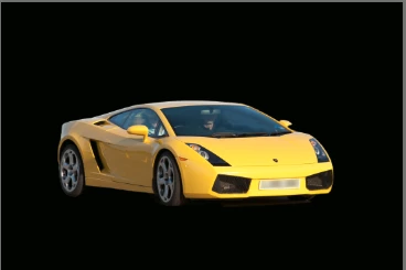

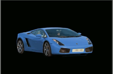

To continue JJMacks theme :
This
+ this
Dave

JJMack
JJMackCommunity ExpertCorrect answer
November 22, 2016
JJMack
