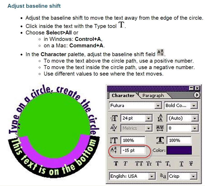

I don't think the baseline shift is what I need, if you look at my current logo, see how McDermott is on top, and you can read it, as it is write side up.  Now, look at "photography", it's on the lower section of the circle, BUT upside down.
Now, look at this pic I copied from the provided link on baseline shift.
See where it says "this text is on the bottom" - it's written write side up, where as mine (the word photography) is upside down.  I want photography to be write side up.  So, on the top of the circle, where it reads McDermott - on the lower 1/2 of circle, I want photography to be write side up - so the P in photography would be located by the M in McDermott if that makes any sense?

No problem.  I think you mentioned the answer back up the thread - you have to use two layers.  Do what I said in post #5, and start at the top center with justify set to center, and type in the top half. This will create a named path for the top half text.
Go to your paths panel, ctrl (Cmd) click your circular path, and use the type tool at the bottom of the path.  Don't worry if it is upside down.
Now select the direct selection tool (black arrow) and hovver over the text untill you see a double arrow, and carefully drag it inside the circular path so it is the right way up.  You'll probably have to fix the character spacing after doing this.
