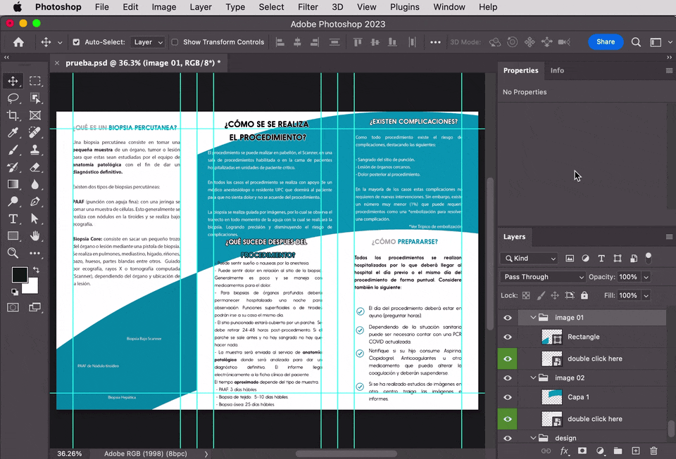

For image 1 (layer “Capa 1”), Replace Color works if you have done the first step of selecting what color (and optionally color range) you want to change. After you click the image to select the color, you will see the effect of the options at the bottom. The first step of selecting the color is because this command is normally used on a photograph with many colors, so even if the layer has only one color like this layer, you still have to select that color first before you can see a result.
In the demo below, I use a different method for Image 1. To make sure I am changing the color of all non-transparent layer pixels without having to select anything, I decide to use the Color Overlay layer effect instead. This also makes it very easy to change the color later, by double-clicking the Color Overlay effect in the Layers panel.
For image 2 (layer “Rectangle”), Image > Adjustments commands such as Replace Color are not possible because it is not a pixel layer, it is a shape (vector) layer. Fortunately, it is much easier to edit the color of a shape layer. I select any shape tool, which makes the Fill and Stroke options appear in the tool options bar at the top. Change the Fill color, and it’s done.
