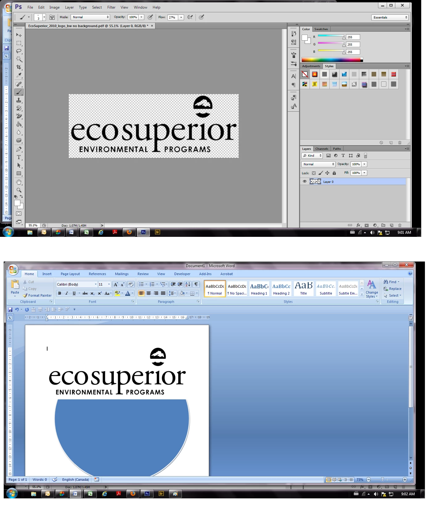

    I had some success with this....in Photoshop it looks like I have a transparent background but when I insert the image in Word over a coloured background, the white is still there.  I’ll paste these below.  I cropped it a bit, too.  (hard to tell but it's the grid behind the word now not white.  I even remembered inside the 'o' for instance! :-)
    oh, and I saved it as a jpeg.  That should be fine, right?
    Ecoway, JPEG files do not support transparancy, so when you save to that format, the background is automatically made white.
    Save to a PNG (recommended) or GIF format.
