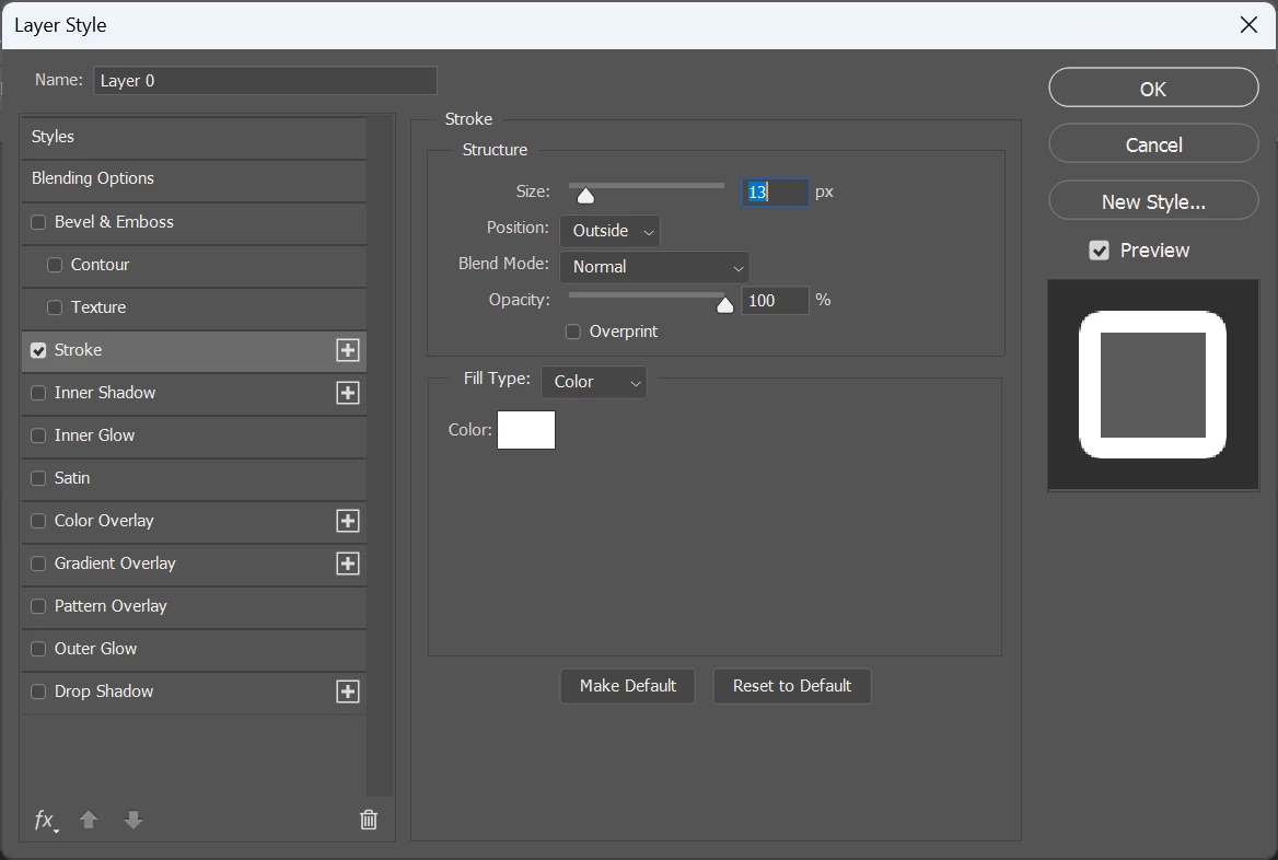

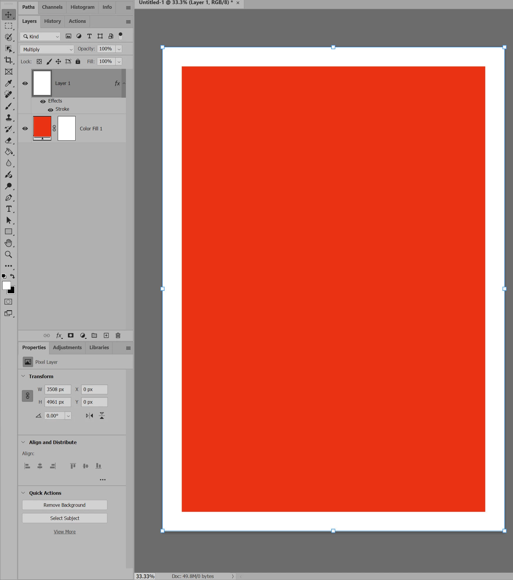

    Borders on images without rescaling.
    Open Layer Styles with double-click on Layer.
    Set Stroke to desired size and color. See screenshot.

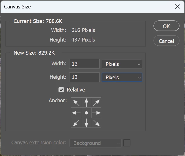

    Go to Image => Canvas Size
    Add Stroke Width Value (13 pixels) to Canvas width & height.
    Equal Borders on all sides.
    Apr 21, 2026 12:33 PM UTC
    This will no longer be A3 size or aspect ratio, I think that’s the problem.
