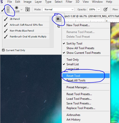

    If none of the above - then try the following :
    1. Reset the brush tool
    Click the down arrow in the the options bar - then the cogwheel then reset tool
    2. Reset Preferences
    Dave
