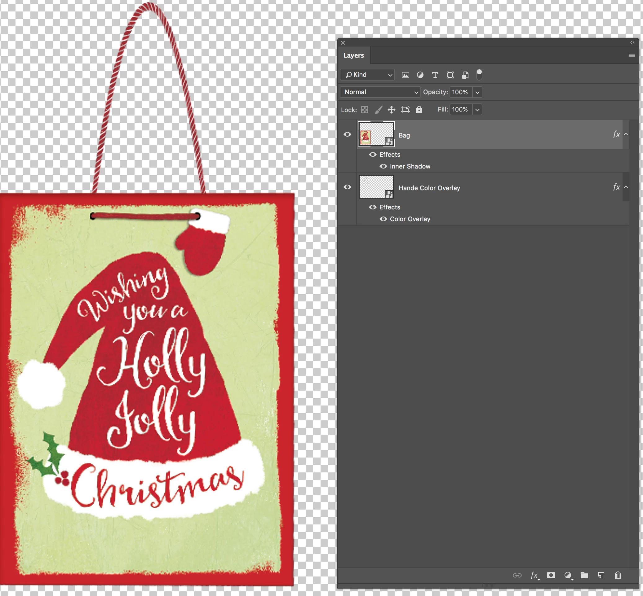

Could you please explain (with the help of screenshots including the Layers Panel) what the problem is?
How are the handles and the rest of the bag connected (or not) Layer-wise?

Thanks. So as you can see below. I have a smart object that changes the bag face. When this smart object updates to another design, I will need to update the handle color above the bag. So i was thinking... if there is a way that i can link a specific pixel or point on the bag face handle (the one that goes horizontal) to the color overlay on the handle above. Now when i update the design. The color of the pixel will change and then the color overlay will update the color of the handle. I do a lot of these updates, so it would same me time if i could have a color overlay linked to a specific pixel.

From what I can see you have handle on separate layer and handle is actually single color with transparent areas, right? If that's the case then you can fill layer with solid color and clip it to layer with a handle instead of using Color Overlay. If your pixel to sample color is always on fixed position then you can record action to sample color from specific, fixed position then to fill layer which is clipped to layer with handle. That's what come to my mind, wait and for other responses.
In fact, if you are using manual method to replace design (double click on Smart Object layer) then you will benefit from action which can help you to edit Smart Object content and then to sample color and fill layer clipped to handle layer, as previously explained.
