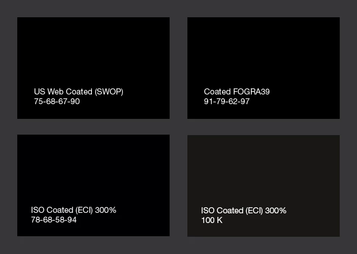

Here's rich black in three common CMYK profiles:
Note that ISO Coated has 300% TAC, and FOGRA 330% TAC.
Actual ink on actual paper is a different story, and in reality they will reproduce much lighter than this.
I have not had time to check what happens when you push K, but still stay within TAC. Which was sort of the whole point of the thread - but I think the background needs to be clear first.
