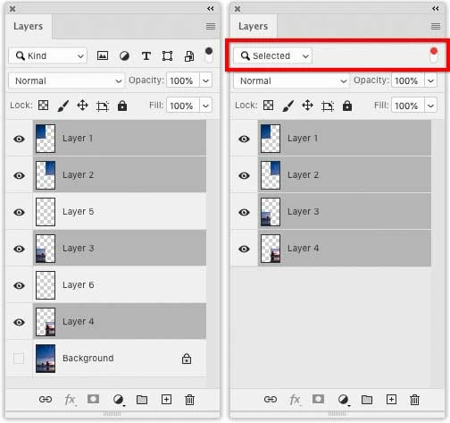

One thing that could simplify that: Use the filter menu in the Layers panel to list only the layers you selected, and hide the rest. That should greatly reduce the amount of scrolling you have to do when Ctrl-clicking to select each layer. When you're done, click the filter toggle on the right to show all layers in the panel again.
