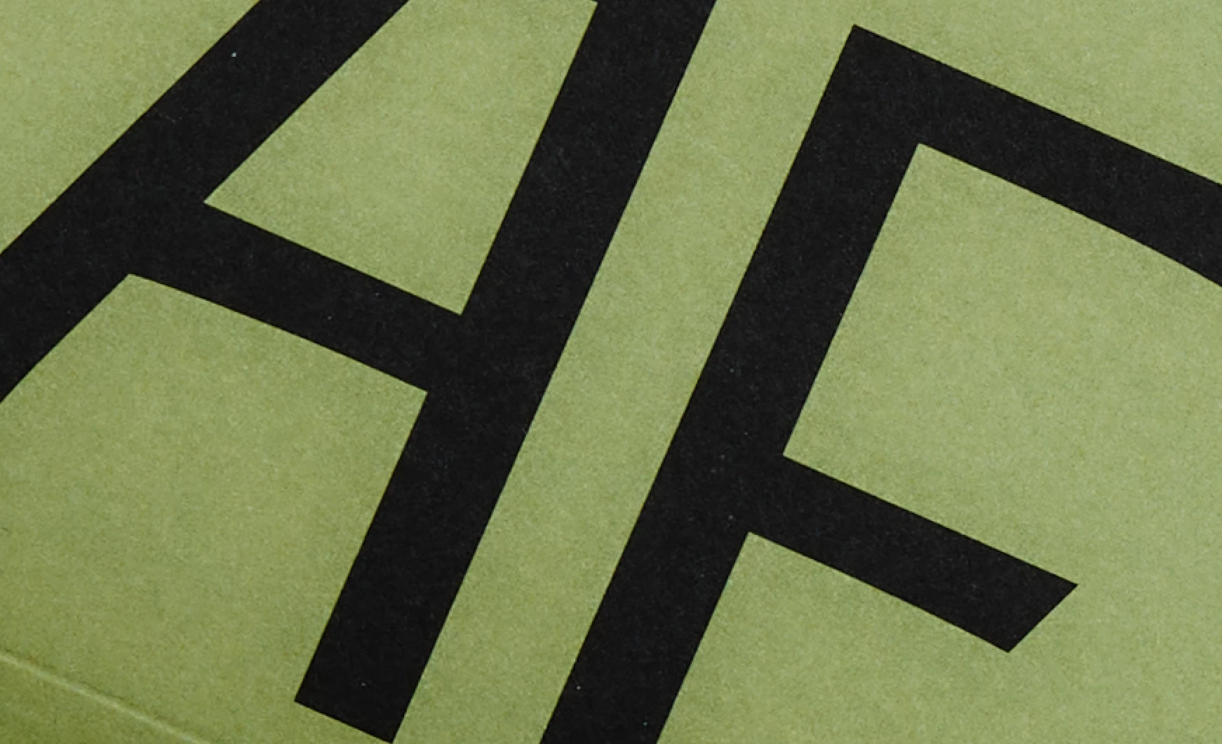

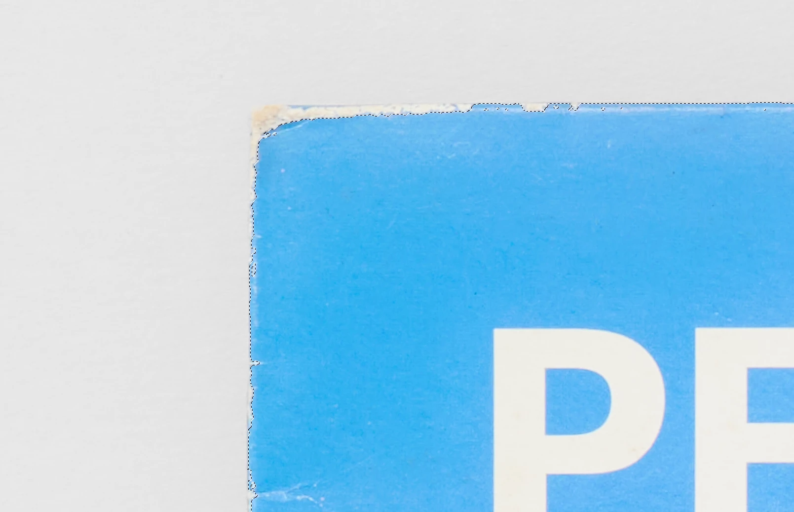

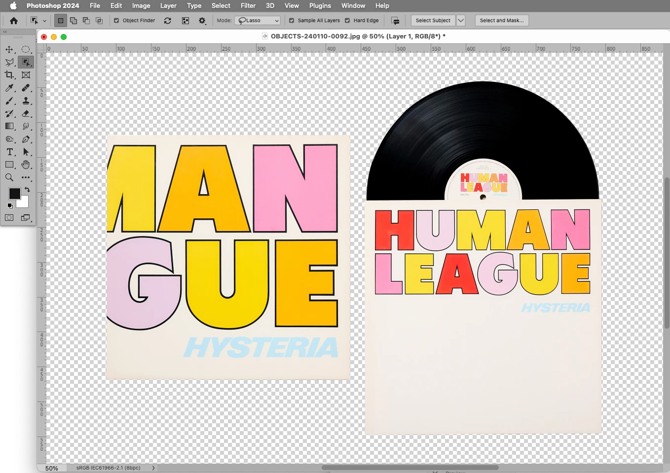

Myra - thank you, that's very helpful. I found the Object selection worked well on this image, but I should have posted the orginal image beofre the background colour was altered - sorry about that. I'm attaching below. As you can see the light colour of the record sleeve and the light background are very close to one another and difficult to select. This si quite an extreme exmaple, which I guess is why I chose it. Any ideas for improving my selection skills here? I'm also attaching another image which shows an Object Selection on an image with a darker object. The trouble is, the edges of an object are often not perfectly solid, so the selection skips part of it out, and I have to go in manually to fix it. All of this would be fixed by using a darker or coloured background, but unfortunaly I can't do that for reasons relating to the brief and photography. Thanks also for your thoughts on the Camera RAW dusting. There is a similar option in Capture One but I've never really used Camera RAW - I will give it a go. I'm attaching an example of the dust/marks I'm talking about, which seems a bit more tricky. This is a close up and I need to remove these sorts of marks all over the dark areas of the image. Some of it is in the print and can't be remoeved and some is probably dust missed by the compressed air. I wonder if there are even less laborious ways to deal with dust/marks like this - any ideas?

With that file the Object Selection Tool still seems to do »fairly well« but a need for manual amendations seems close to inevitable.
