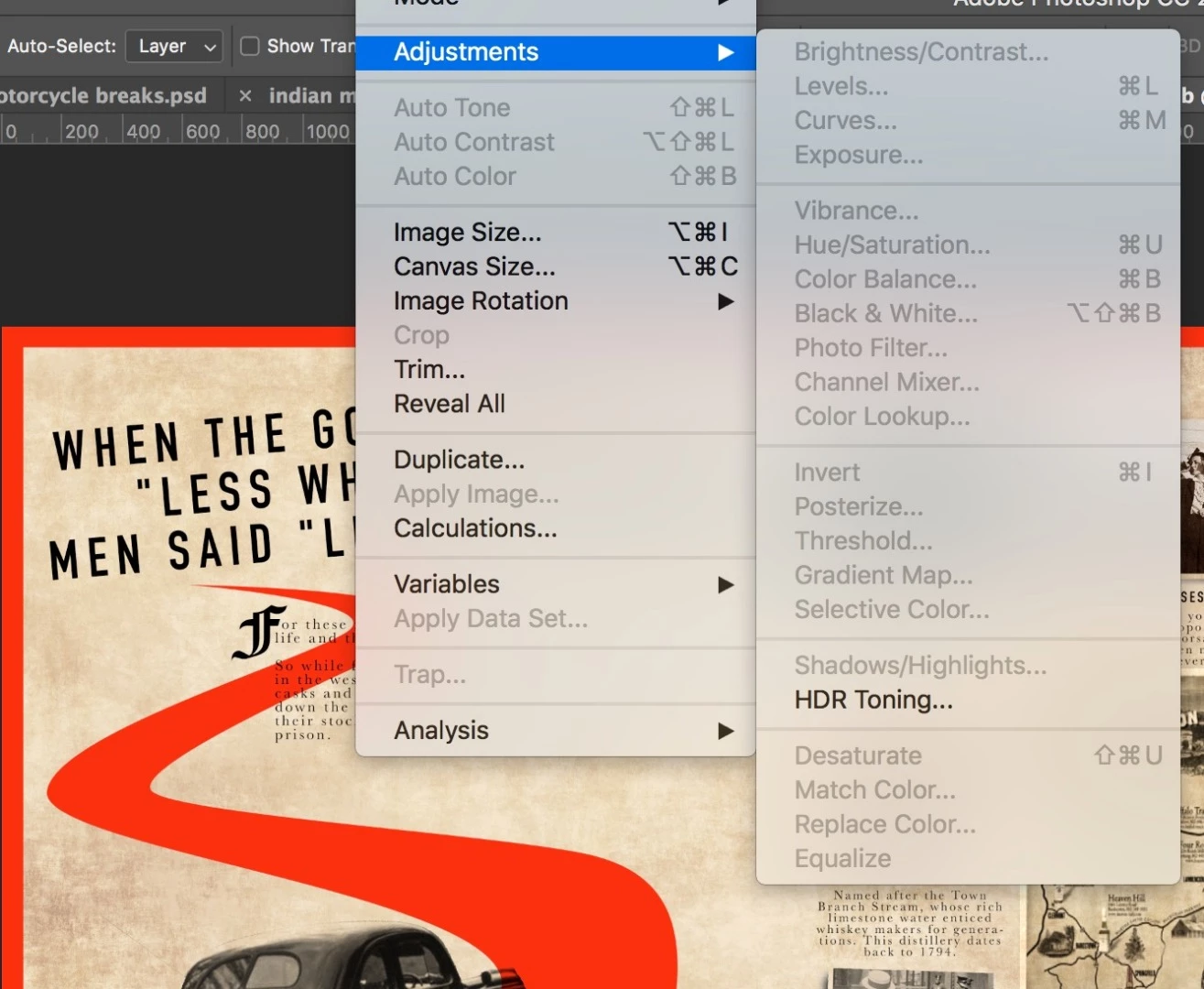

I have several red graphics that I'd like to change the color of. I would like to use Replace Color but I can't get it to be active. (
( i'd like to replace this red)
all these adjustments are greyed out.
Thanks!

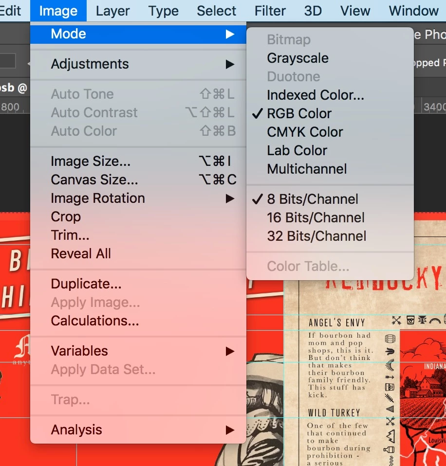

    It's on 8 bit.
    Another possibility: you have the wrong layer selected; a text layer. That gives me the exact same screenshot as you get.

    Check under the 'Image - Mode' that you're working in either 16 or 8 bit. If you go higher you will see the replace color is greyed out.

    Looks like this is a 32 bits/color HDR image. Most adjustment tools don't work with that (also depending on your version of Photoshop).

    Hm... how can I check? I'm using the most recent version of CC photoshop.
    davescm
    April 11, 2018
    To check use menu Image >Mode
