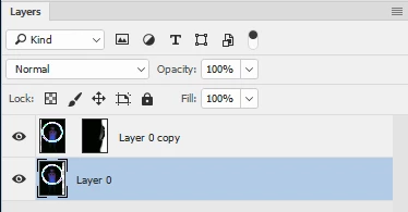

Nothing to be nervous about - when you are painting on the mask you are only hiding and showing pixels - the originals are not being altered. If you get it wrong just change from black to white (or vice versa) and paint over it.
I used a fairly small brush and painted most of the light trail black so the original right hand side showed.  The blend to the new was easy with those light trails. I used a soft brush (hardness 0%) and built up the opacity (set the brush to c 20%) and I used brush strokes in the same round direction as the light.

You could just extend the canvas, duplicate the layer  - flip it and then mask it so that the left side of the original image fills the gap on the right

After you Flip the layer - turn the opacity down to around 50% so you can move it and line it up. Then just paint on the mask with white to show the top layer and black to show the bottom layer

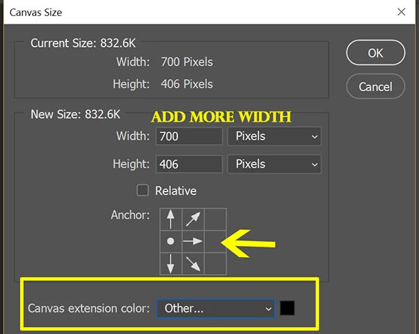

1) Make a bigger canvas.  Go to Image > Canvas Size.  See screenshot.

The image is flattened. I will make the canvas bigger. using this.
