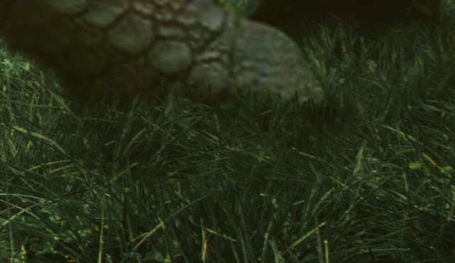

You have sunk the feet into the grass hiding the base of the feet, but more importantly, you have either made a good selection of the grass, or painted grass in front of the feet.  You have also got shading pretty good at the bottom of the legs.
I 'borrow' clumps of grass from the original scene or another image.  I usually use the Quick Select tool to make the rough selection, and let Select & Mask fine tune it.  You can improve the clump by adding a layer mask and using something like a scatter brush, or even one of the Legacy grass presets byt painting with black in the layer mask.

So even a thin shadow along the transition would make a difference.  Run a path along the line the shadow should follow, and stroke the path with the brush tool with size jitter set to Fade.  With the very high res image you uploaded, the fade value would need to be way up...  about 4000 or more.  Add some gaussian blur to your new shadow, but make the shadow layer a Smart Object forst so you can fine tune the blur.
Or you could make a brush:
Start with something like a hair brush preset like this or similar.  Or just lay down some thin random lines.
Still set size jitter to Fade.
Angle jitter to max
Add some scatter jitter
And forground/background color jitter (but no hue jitter)
That would give you something like this
Add some dark brown shading behind it, and you have an instant grass edge.  You'd need to clip a curves layer to it to control brightness, but remember it is easier to make something darker than it is to make it lighter without it turning to mush.

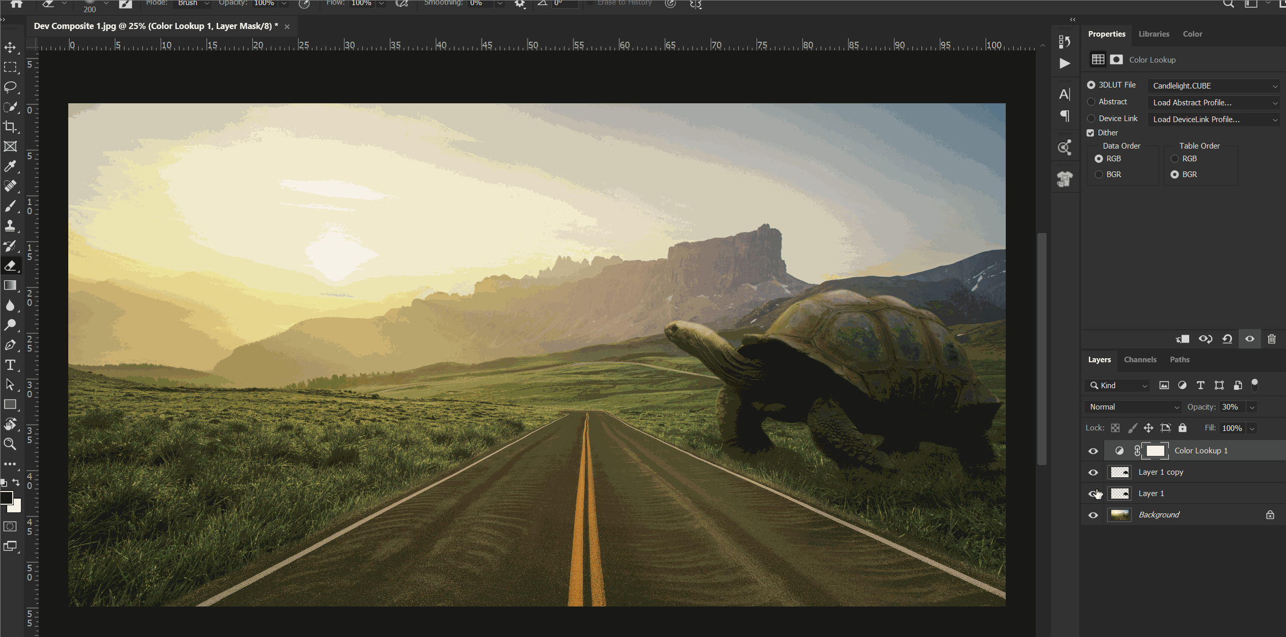

That is a great looking composition for a first try. I would just darken the Tortoise's shell a bit, as there is no light source in the top and the Sun is in the background.
I added some layers and used blending modes to blend them. Then I used the color lookup table to add a color tone to match up the whole composition.
Here's the final result:
