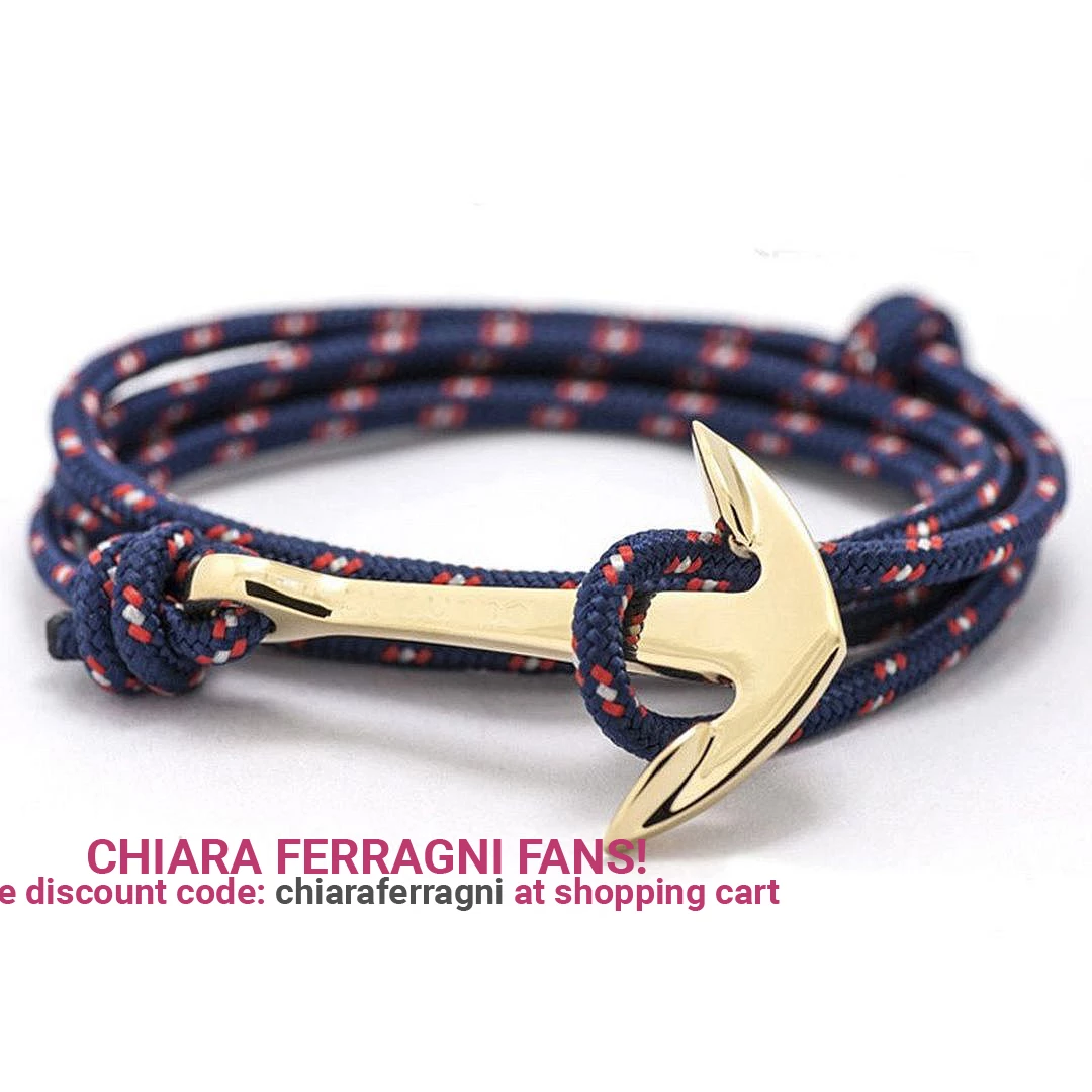

Now the strange thing is that there are mistakes in the processing on about 34% of the images. The mistakes are not the same in all the images and seem so random.

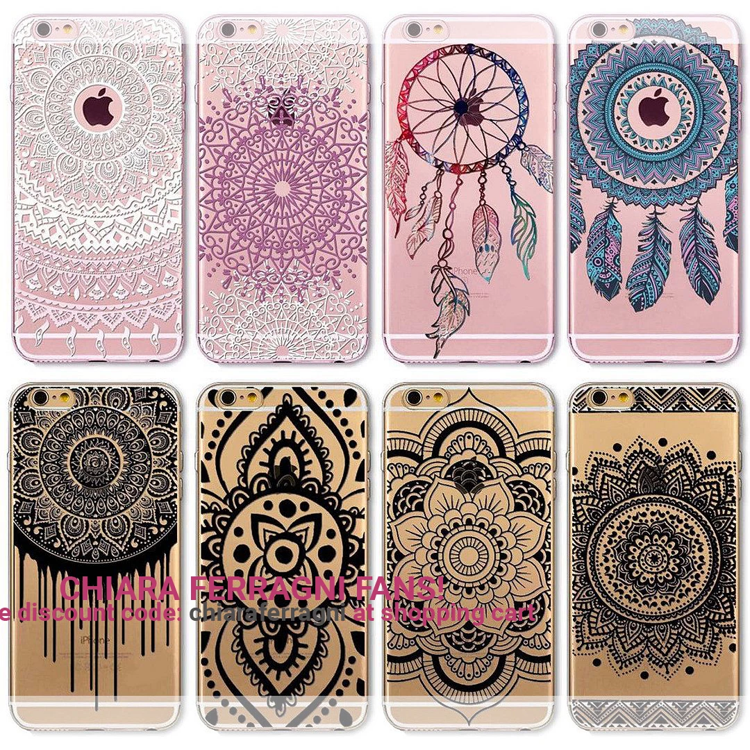

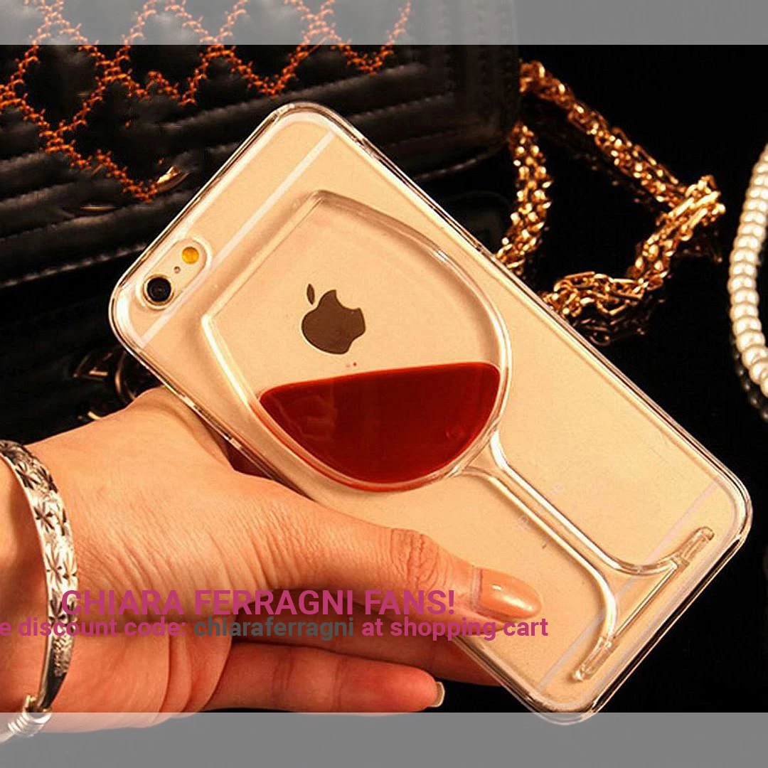

Then some examples of the 34% of images with mistakes, there are different kind of mistakes but they all have to do with applying the opaque fill in a wrong way
one picture also gets nothing applied at all (the last one):

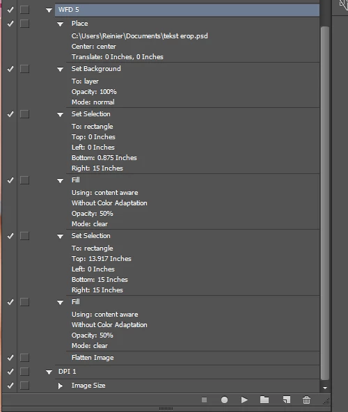

    c.pfaffenbichler​, sorry forgot about that. Here by the steps again but now expanded.

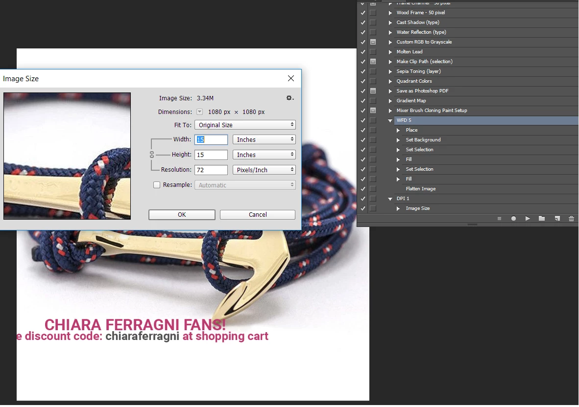

    Set selection is in the correct position, these are the opaque layers and they are in the correct location on every image. Place is the text itself and that is in the wrong location. Place is to much to the left and to the top. How can I center with some aligning in the Action, at place its says Center:center already? If the placemend is correct in the example file that I used to make the action then it should be correct on all the images that are the same size right?

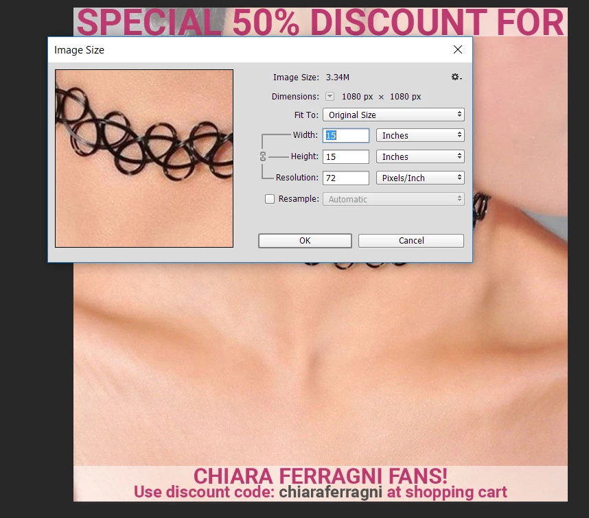

    I think so yes. How can I check the pixel dimension? I added the exact picture specifications bellow:
    I also opened the image dimension in photoshop of 1 image that was succesfull in the task and 1 that failed. To me it looks the same:
    Succes:
    Failed:
    I also printscreened the expended action, it is about action WFD 5:
    c.pfaffenbichler
    February 10, 2017
    The individual steps are not expanded so one cannot tell what exactly you recorded.
    Do the »Set Selection« parts work as expected?
    Is the issue the »Place«? If so what are the parameters exactly?

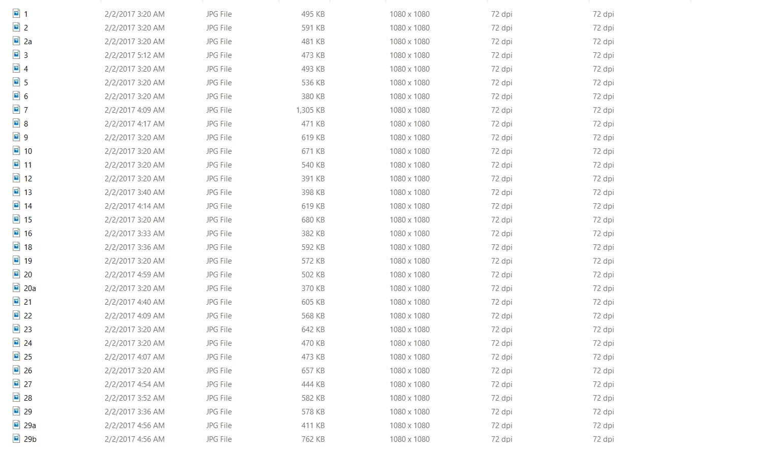

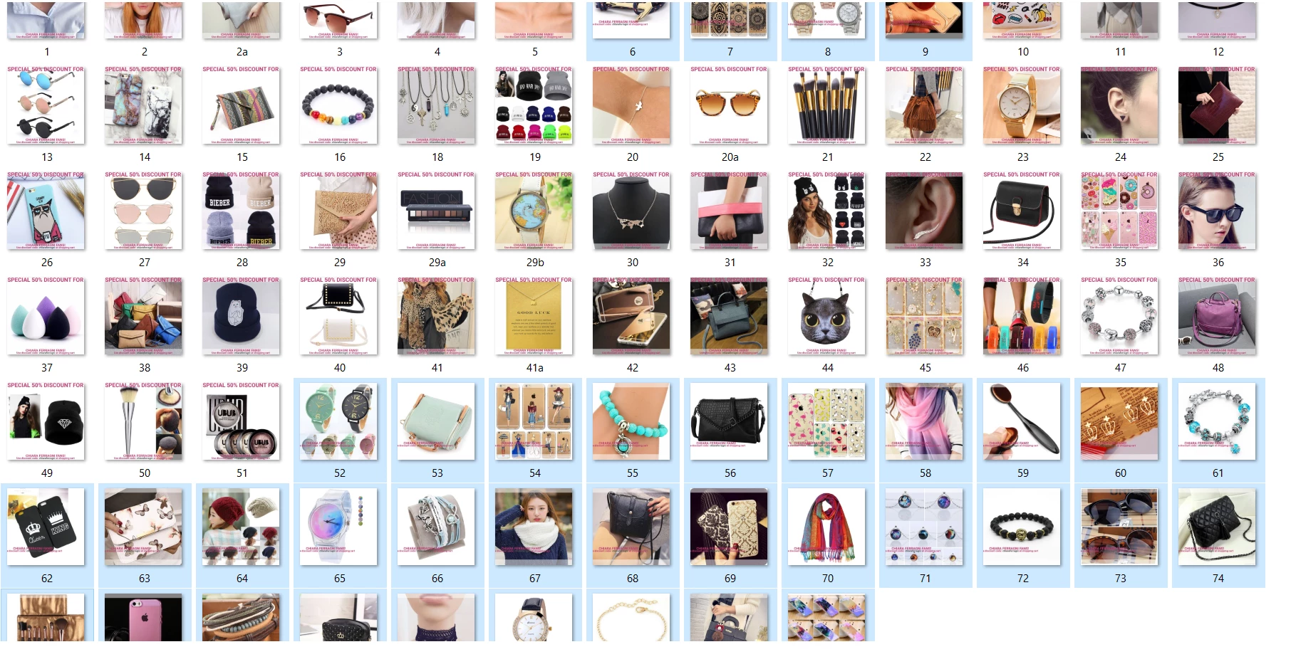

    c.pfaffenbichler​, I did that and the DPI of all images is 72 now, I runt the DPI action on all images to make sure they are 100% the same. I ran the batch again and now some images (36 out of 83) show a different problem see bellow. All the images with a problem show the exact same problem now, do you have any idea why this can be?
    Mistakes seem te happen in a row, I selected all the mistakes in the folder so you can see that it they are in a row:

    So the images definitely have the same pixel dimensions and the same resolution?
    Please post a screenshot pdf the expanded Action in the Actions Panel or the atn-file itself.
    reinierk24239981
    February 9, 2017
    JJMack and c.pfaffenbichler​, thank you for your replies, size was all the same I just found out DPI was not the same. Thanks to this I spotted where it goes wrong. Most if my images are 72DPI these all turn out ok. Other images are 2, 96, 100, 120, 300 and 350 DPI, is it safe to change all my images to 72DPI and will this mess up the quality of the images if the value used to be higher as 72DPI?
    If its safe how would you recommend me to change the DPI value to 72 for all files? I tried adding flatten as last step in my action, this did not help, mistakes remained the same.
    c.pfaffenbichler
    February 9, 2017
    Changing the resolution via Image > Image Size with »Resample Image« turned off will not cause image degradation as the actual pixels are left unchanged.
