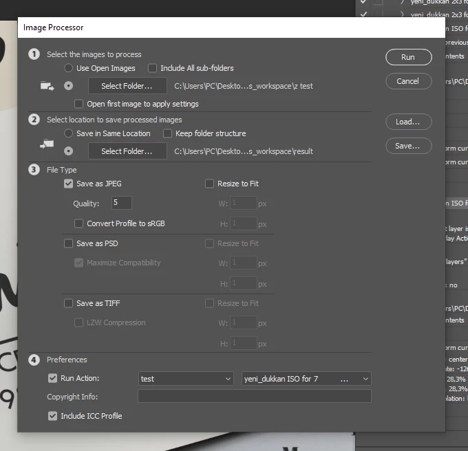

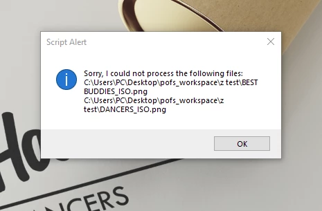

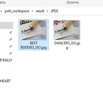

Image Processor takes the images, apply the action and succesfully save the files in the correct folder. But for some reason, it gives me a Script Alert saying "Sorry: I could not process the following files: <input image file names and paths>" as you could see from the pictures too. Is it something that I should worry about? I want to automatize my work but I don't want to risk any mistakes. Also, I ran the same script a couple times and once, only one file was saved when it had to save both of them, which was just unexpected for me. I did the same thing once again and both files were saved. I'm kind of confused, what should I do?

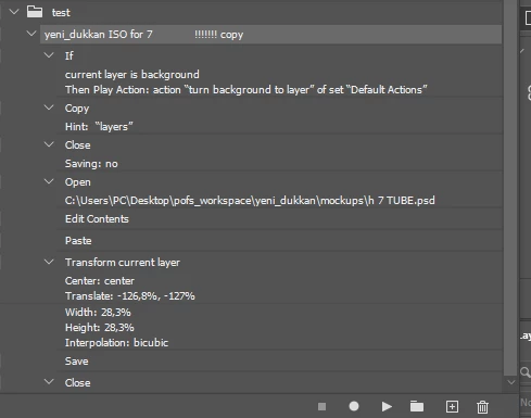

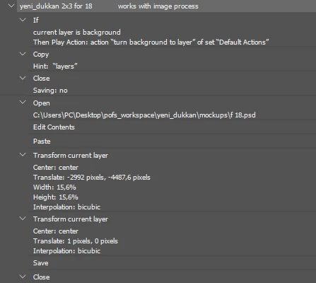

Here, I did the third try with this script. The first two try was also clones of it only opening different mockup files.
June 29, 2022
Hello @CShubert , I'm copying an image then pasting it inside a mockup file. No, my action seperately opens the file, pastes the content, then saves the file and close it. Also, a new update, I tried it three times, with 10 input images but it only gave an output of 26 images instead of 30. In the third try, it didn't save 4 of the images. Yes, it still gives the error after it's done.

Hi @pofdzm25021178jkk3, the team has asked for some more info.
  1.  What are you trying to paste? File type, content, etc? In your scripts we see the pasting step, trying to clarrify what is being pasted.
  2. If the content is from a different file, is that file OPEN when running the script?
