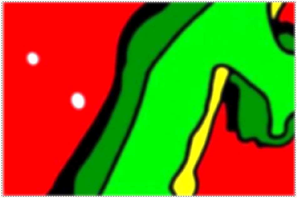

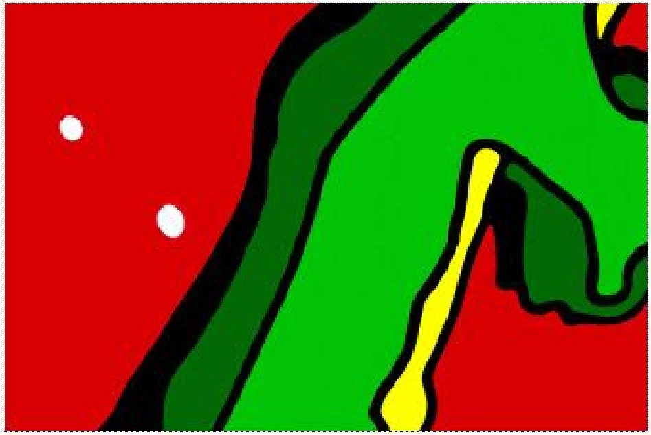

Trevor.Dennis
February 20, 2019
Select a frame, and give it a slight Gaussian blur.  I used a value of 1.2 pixels.
Then Levels to harden the edges back up again.

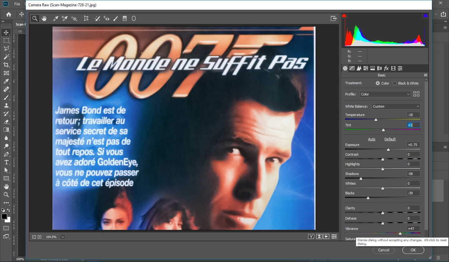

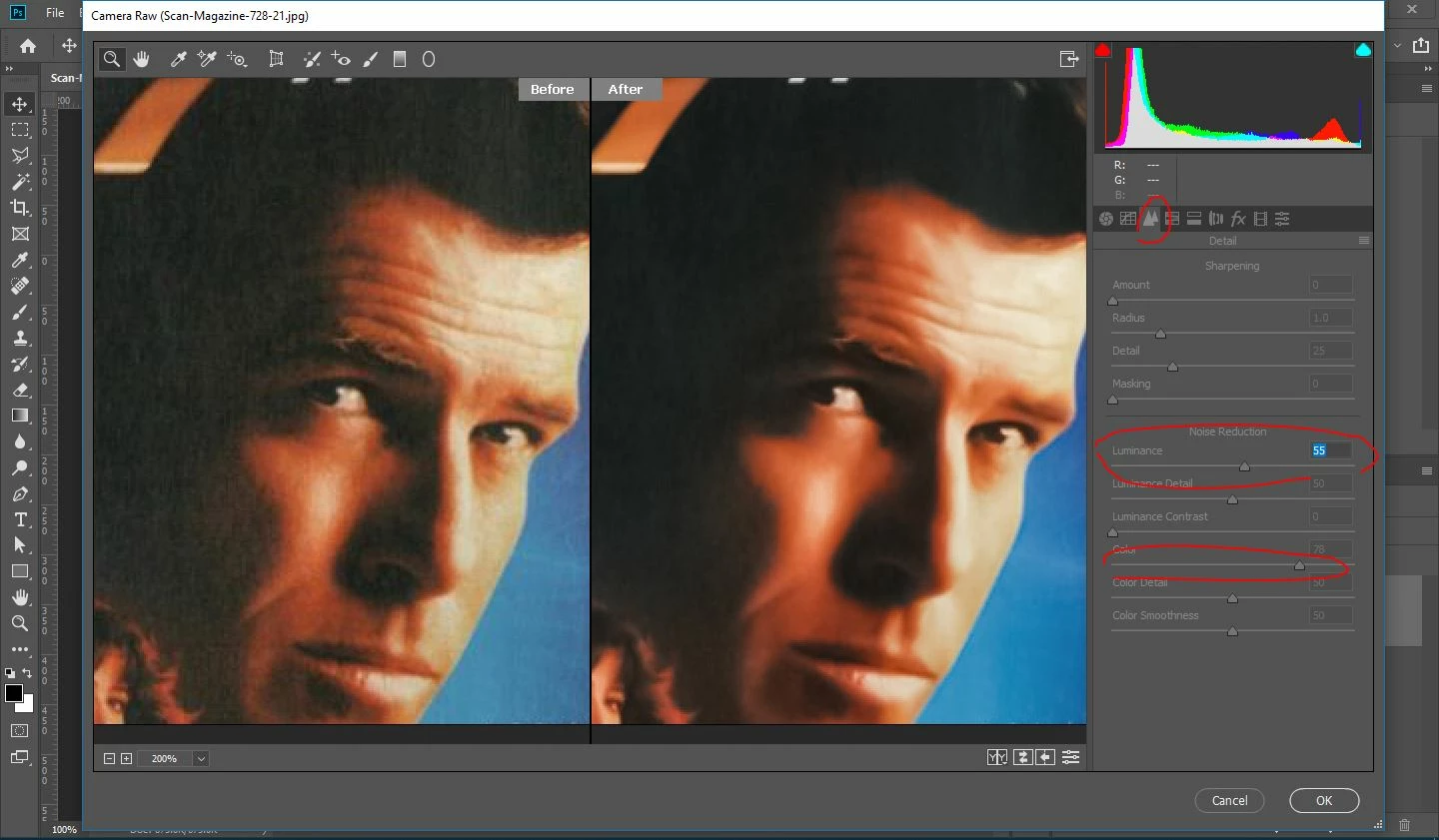

Omar.Fathy
February 16, 2019
In this case, using Camera Raw Filter from Filters Menu will give you a good and quick results.
From the Basic Tab you can adjust colors.
and from the Details tab you can fix the noise by increasing the noise reduction and increase the Color noise reduction.
joe6801Author
February 20, 2019
Oh wow. That really makes a difference.
