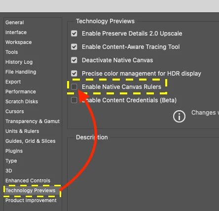

March 1, 2022
I fixed my « blank workspace » issue by unckecking this option:  PreferencesTechnology PreviewsEnable Native Canvas Rulers

By @MartinDube
trishd42
August 26, 2022
Thanks Martin your fix "Enable Native Canvas Rulers"is the only one that worked for me. Very much appreciated
