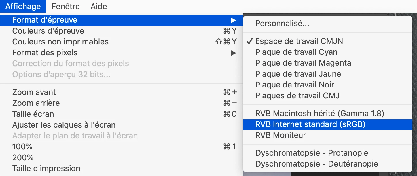

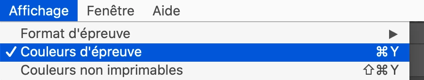

didiermazier
September 9, 2020
Just  2 questions … (sorry for the french UI)
  • Did you activate the correct proofing space you intend to show your work?
  • Then did you check on color proofing?
This is ensure that Photoshop will do is best to emulate on your screen what will be seen on the color space target
