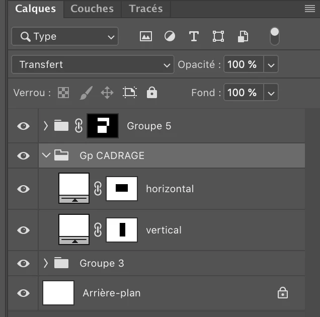

Hello, despite all my researches i am struggling on this, i need to export multiple crops of an image, determined by the layers in the group "Gp CADRAGE".
I need to either :
- get the layermask active, invert it, and then crop to bounds of the mask
- or get a selection of the layer mask of active layer, invert it, and then crop to doc.selection.bounds
I tried to get a selection from the layer mask and then invert it, but i cannot select the layer mask propertly.
I tried to invert the alpha channel but i cannot get the alpha channel of the layer mask active.
I suppose that we can do it with actiondescriotor and actionreference etc, but don't understand how it works yet. So didn't get the code i found on the net to work 🙂
Thanks a lot if you can help me !
Martin
Correct answer Stephen Marsh
 Here is how I would do it:
// Replace the layerName variable with the required layer name, i.e. "vertical"
selectLayer("horizontal", false);
// Load selected layer mask channel as selection
setSelectionToMask();
// Invert selection
app.activeDocument.selection.invert();
// Crop to selection
var idCrop = charIDToTypeID( "Crop" );
executeAction( idCrop, undefined, DialogModes.NO );
// Deselect
app.activeDocument.selection.deselect();
// Functions
function selectLayer(layerName, makeVisible) {
	var c2t = function (s) {
		return app.charIDToTypeID(s);
	var s2t = function (s) {
		return app.stringIDToTypeID(s);
	var descriptor = new ActionDescriptor();
	var reference = new ActionReference();
	reference.putName( s2t( "layer" ), layerName );
	descriptor.putReference( c2t( "null" ), reference );
	descriptor.putBoolean( s2t( "makeVisible" ), makeVisible );
	executeAction( s2t( "select" ), descriptor, DialogModes.NO );
function setSelectionToMask() {
	var reference2 = new ActionReference();
	reference.putProperty( s2t( "channel" ), s2t( "selection" ));
	reference2.putEnumerated( s2t( "channel" ), s2t( "channel" ), s2t( "mask" ));
	descriptor.putReference( s2t( "to" ), reference2 );
	executeAction( s2t("set"), descriptor, DialogModes.NO );

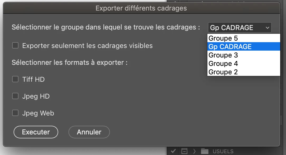

martinj65399781
March 28, 2021
Thanks you ! i took only the part i needed, just to make a selection of the layer mask, it seems to work perfectly !
So here is the part of code where i use your code 🙂
    doc.suspendHistory("Exporter en jpeg web en local", "exporterDifferentsCadrage()")

martinj65399781
March 28, 2021
thank you for your answer, but i need to make a crop out of the selection, so making a selection from the rgb channels will often make a selection of the whole canvas 😉
Stephen Marsh
March 28, 2021
The ScriptListener code that I posted was just a quick way to select a named target layer inside a layer set and to then load the mask channel as a selection in order to crop. There were a whole lot of assumptions that had to be made. Without having sample files and knowing how consistent multiple files are, one can only do so much. The code worked as intended when I made a simple test file based off your screenshot where the layer mask content was not full canvas.
