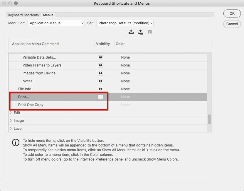

    One approach to this is to simply hide the print commands in Photoshop. Adobe even provides tools for this.
    Choose Edit > Menus and deselect Visibility for the Print and Print One Copy commands.
    As you can see at the top, menu configuration is part of the Photoshop Defaults file, which means the preferences file. Because hiding commands is a Photoshop feature, there are undoubtedly some students who will read the Photoshop help files and realize why the Print commands are missing. To try and hold them off as much as possible, you could try the following:
    • Prevent student access to the folder containing the Photoshop preferences file.
    • Lock the Photoshop preferences file so they can't reset it.
    I'm not sure how effective this would really be. Also, the dialog box above does not let you hide the Menus command itself, for obvious reasons. So any students figuring this out could try to simply enable visibility for the Print command. Although that may or may not work if the preferences file is locked.
    Of course, locking the preferences might conflict with lessons that require altering preferences. It's all a tradeoff, however you do it.

    Also, as long as those commands are hidden, students can't learn how to print in Photoshop
    Even with them commands hidden they can still hit Ctrl + P to bring up the print dialog options
    Conrad_C
    July 17, 2019
    Of course, the keyboard shortcuts are also configurable, so if someone was to go down this road they should also remove the Print keyboard shortcut.
